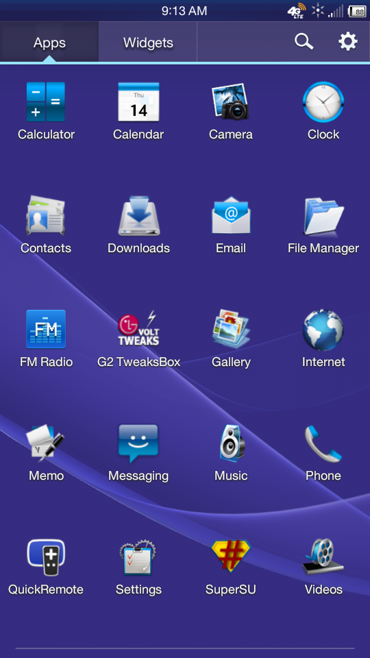

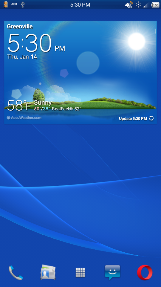

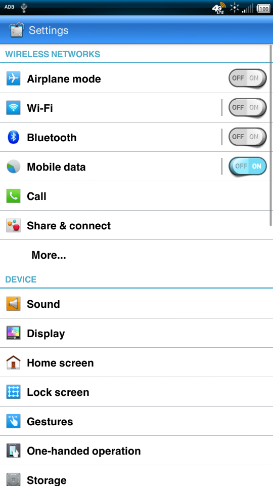

I have not forgotten you guys. Really polishing off the final. Want it to look good and be right. Recreating weather altogether for the original weather...not the trans or semi trans... plus got a good start on changing framework and lge res elements as you can see in screens below,will hopefully have it done in days.
Now the framework changes may not stay. am having trouble making each app obey the new design you see at top of settings pic above. contacts,dialer messaging,videos and a few others work fine with it but some third party and other stock apps want to bug out...will see.

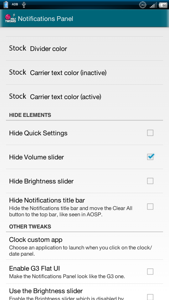

Couple questions, is there a way to get rid of the volume slider in the notifications menu?
Is there also a way to change the color and how fast the front led light blinks?
Great rom by the way running well on the sprint and boost versions currently.
you can turn off the volume slider in volt tweaks,aka g2 tweaks.

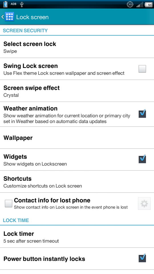

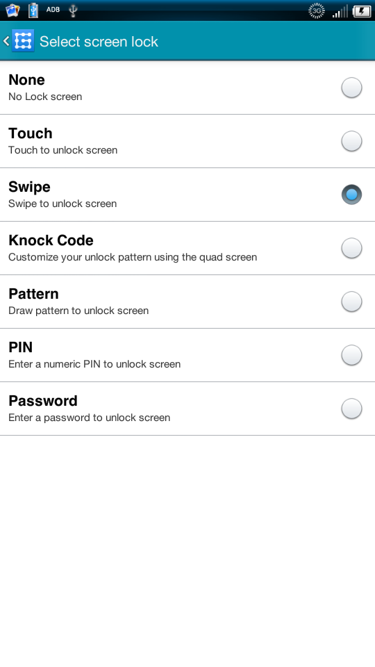

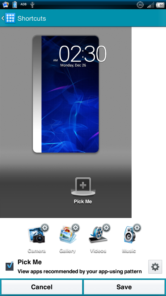

as for the coloring and blink speeds. i do recall seeing some bools related to that on settings apk. will see if there is a way to add something there. currently trying to reactivate removed/hidden lock screen features..
so far ive gotten pick me feature working for lockscreen shortcuts...almost working weather animations and touch to unlock feature...buggy the last two though..
