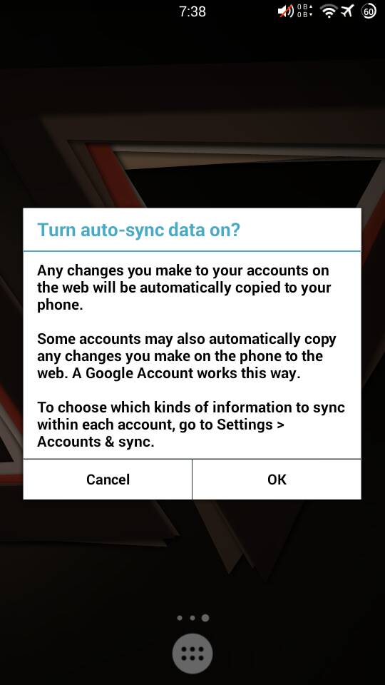

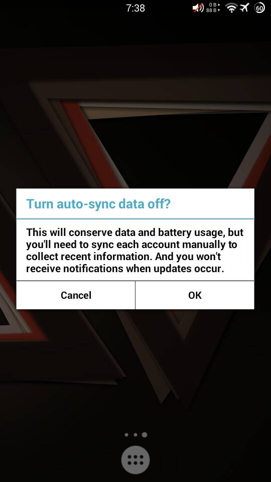

Whenever I toggle auto sync from the notification panel it asks for a confirmation. How do I stop that? This only started asking for a confirmation recently but I don't remember changing anything that might've caused that. It's VERY annoying
There is probably a way to stop the notification pop up but will require decompiling systemui most likely and either making an edit to smali,changes in the values folder like bools.xml or other. Never encountered the issue myself. But never used auto sync either so it may or may not have been there. It isnt a bug but would be annoying to me as well. Same thing occurs I do know with airplane mode. Or did. I may have removed it.
But this only started happening recently which makes me think there is a setting somewhere that I accidently changed which I am not noticing now.

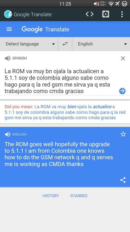

La ROM va muy bn ojala la actualicen a 5.1.1 soy de colombia alguno sabe como hago para q la red gsm me sirva ya q esta trabajando como cmda gracias
This ROM is never going to update to 5.1 and I'm pretty sure you will never be able to use this as GSM.

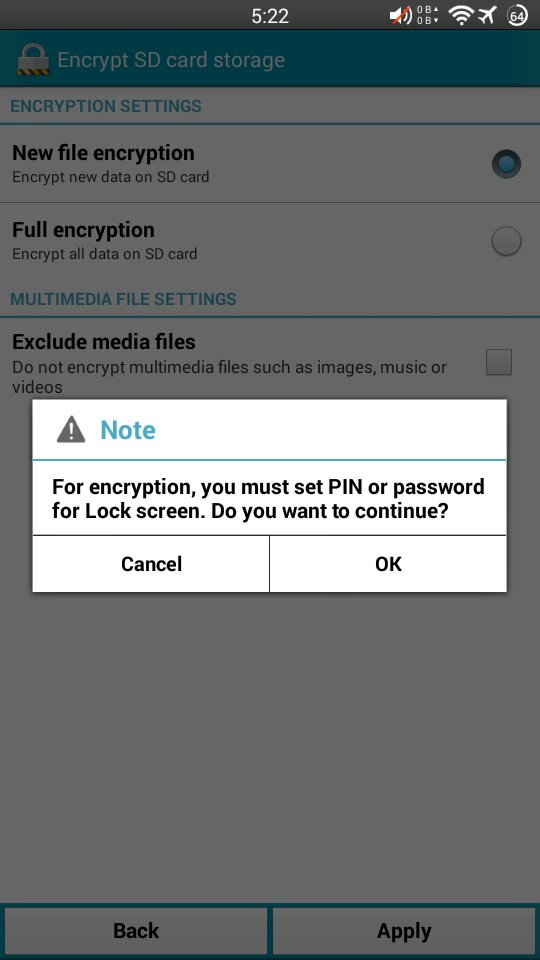

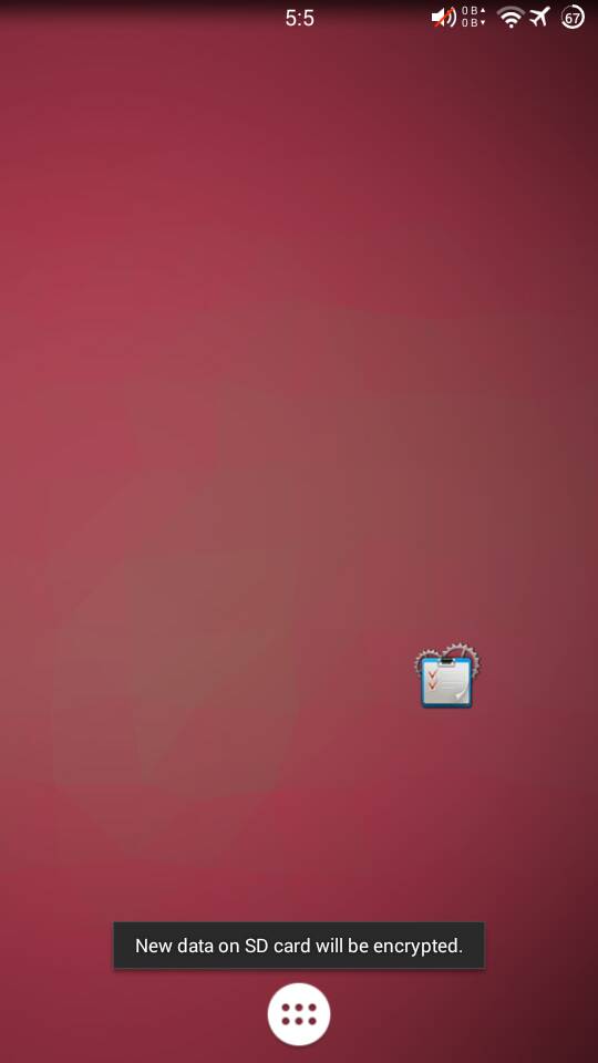

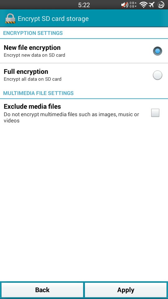

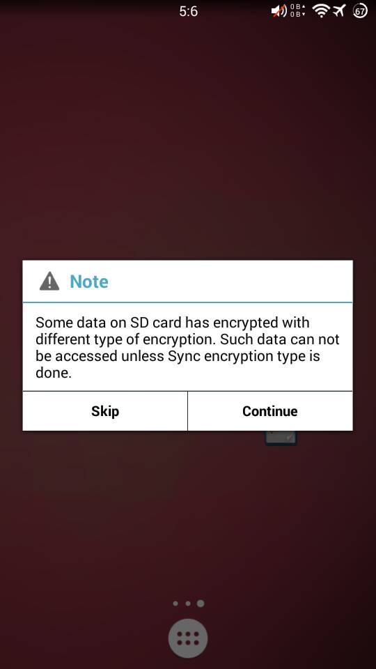

I was trying to toggle auto sync without having to confirm it every time so I figured maybe it's a activity I can launch with a widget since I have Nova launcher. So I find this activity called sync, add it to my home screen, and press it. First that pop-up comes up, so I press skip and that notification pops up. Did I just enable encryption for all future files????
If I click continue that opens and if I click apply that pops up. The activity is called .syncdialog
I have a pattern lock so I don't see how it could've enabled itself
