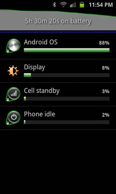

Like I said in previous post, I deep cycled the battery two days in a row, removed the battery before starting the phone, turned off wifi and back on... and then today did absolutely nothing with the phone but let it sit there - no calls, text, nothing. After 5.5 hours, down to 66%, and Android OS is behind it.
attachment.php
