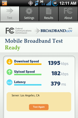

10. Look for M.IP tab and there will be an option under Mobile IP Behavior to set it to Simple IP only select it and then click on write to phone. Phone should reboot.
My speed definately increase from 200kbps to around 900kbps - 1.1 mb Download location: Los angeles
