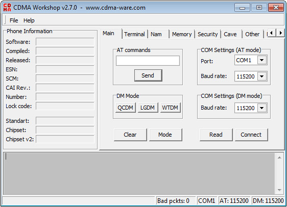

question....how to send the default samsung code??
I have CDMA v2.7...i know that is not latest....will this version work or i will latest version....
i have attached the pic of what i see.....dont know how to send the default samsung code...please help :)
