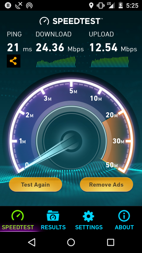

As you can see you'll have a icon in the status bar if you do it right but I need a couple testers too confirm this and time because the gps bugs take time to see
If this works for you that is great. I still have not experienced this GPS issue though. For all those that have the issue do you have the issue in a are with a lot of tall buildings or while under some sort of covered area? These factores can cause issues with GPS do to multipath propagation.
Also from looking at the proposed fix the deleting of gps cache is probably the key factor. Cause the GPS Status & Toolbox app uses A-GPS(assisted gps to help get a faster TTFF(time to first fix). Thus means it uses WiFi and or mobile data to assist in getting and maintaning a GPS lock. This is something not all apps that use GPS take advantage of and only use a S-GPS(standalone gps) which relizes souly on the signal if satelites to get and keep a gps lock. So this makes me think it is not a issue related to the ROM but to tge apps being used for GPS. And the area or even the weather in which the apps are being used. But if someone having the issue can get me a log I will look into it.
