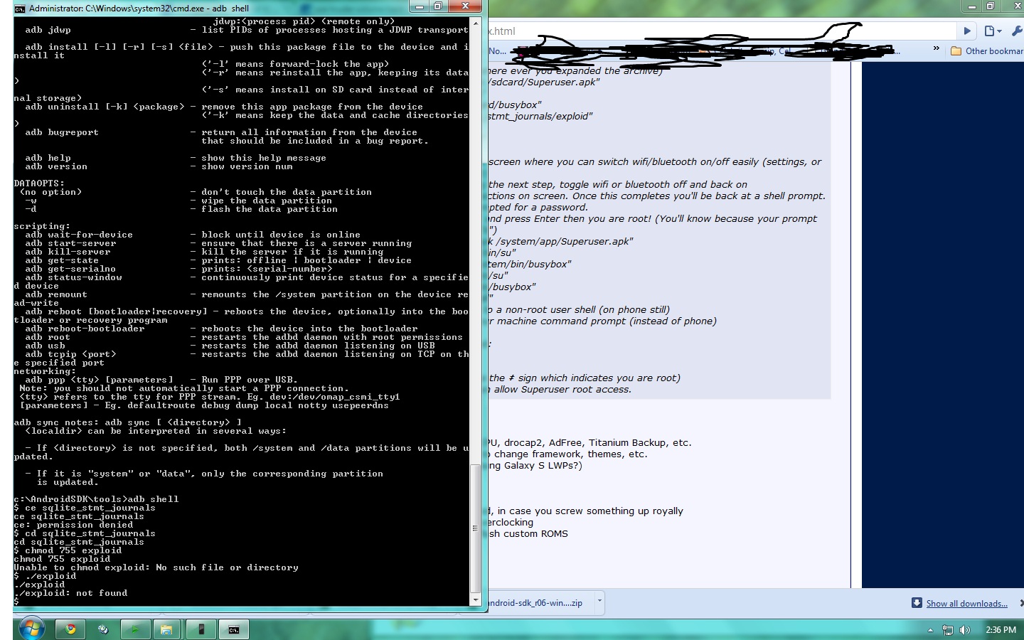

now i get exploid not found..
When you downloaded the zip folder (DroidXRoot) for the root, did you unzip the contents into the androidsdk/tools directory? If not, do that right now and try again and you will be golden.

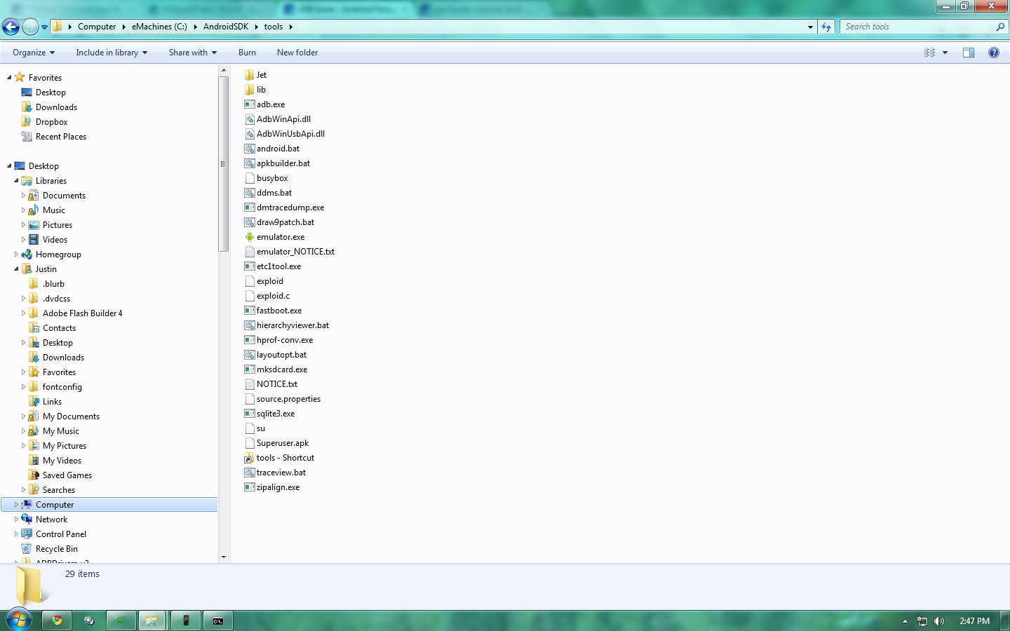

So you take the DroidXRoot.zip file and unzip it. Inside are the following 4 files:
exploid
exploid_c
su
Superuser.apk
Drag the first two files and put them in your androidsdk/tools folder
then follow the rest of the instructions:
yeah i did....and when i go in that folder i see the exploid file.
