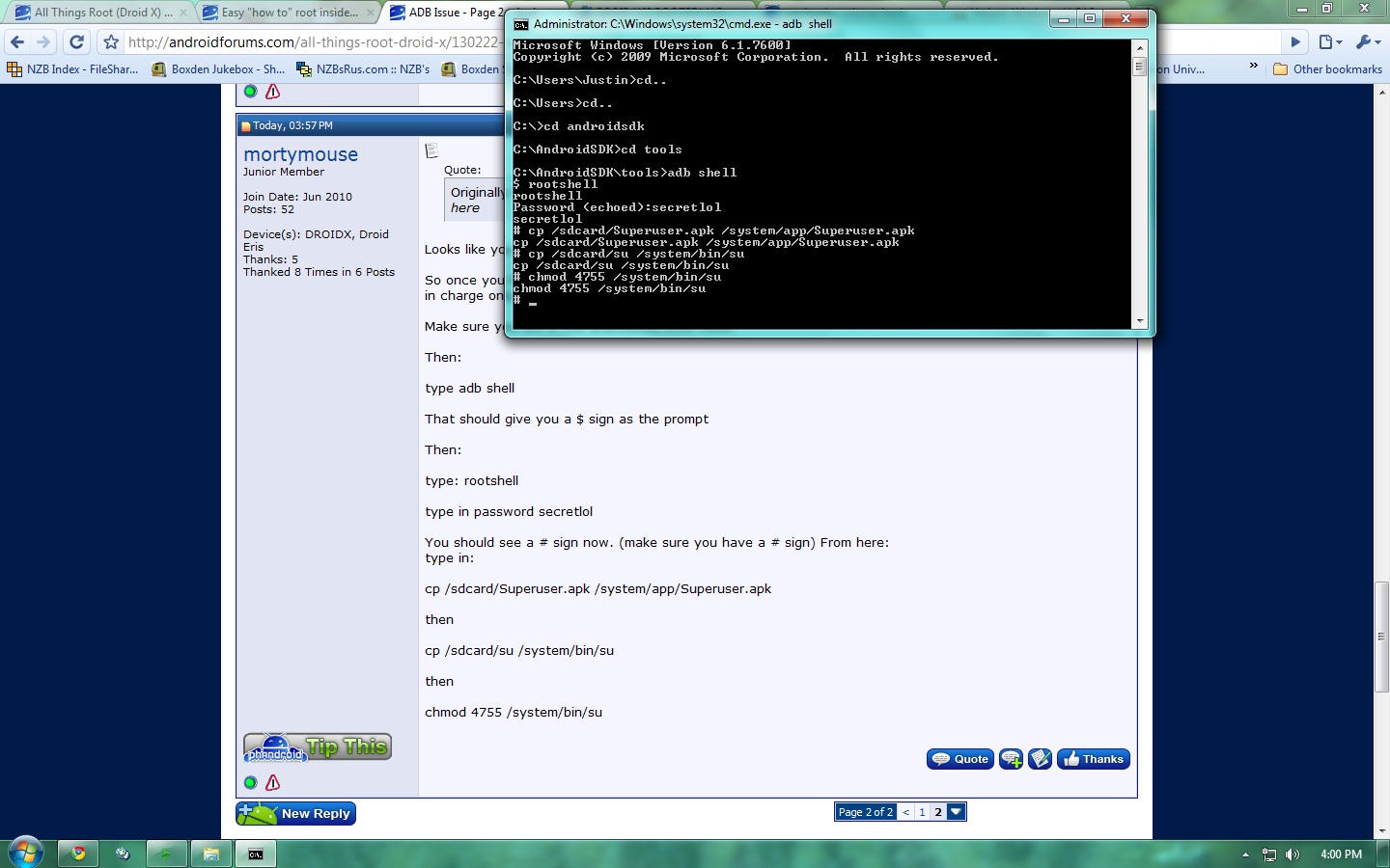

ok i typed all that got no errors or anything
You got it. Reboot your phone and check and see if you have the Superuser.apk listed in your apps. If so, YOU HAVE IT ALL DONE!!!!!!
You have ROOT!!
