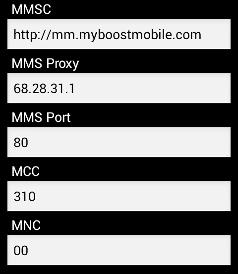

I followed this exactly to a t and my mms still doesn't work, anyone have any ideas??
Click on the go advanced when you are posting and you will see lots of little icons at the top of the text box one is for file attachments and another one is for graphic inserting etc.
Here are the Screenshots. I had to crop them because they were too big.

not blurry for me, I've talked to a couple of people, some who have problems with 68.28.31.1 use 68.28.31.7 and vice versa. I tried both, and they both work for me, give .7 a shot
I changed it and sent myself a picture text about 10 minutes ago, still haven't received it. I did reboot my phone after changing it too.
not really sure what is going on with yours, mine and most everyone else has no problems sending and receiving MMS with those settings
