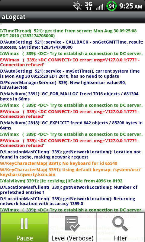

Well, with alogcat I've found that I definitely have a 4G/wimax radio issue. I am using Fresh ROM and updated the wimax radio twice, but this is an error message I get, repeatedly, when my 4G widget is off. The message goes away when I turn it on, but I still cannot connect to 4G where I had coverage previously.
I found a thread on XDA mentioning this error message that I'm going to go through now.

Well it appears that this is relatively common to see in alogcat, so I'm going to flash VirusROM now and see how it goes.
Nope, and bummer.
I had that wimax problem, complete wipe and re-flash fixed it.
Near as I could tell, for me it correlated to a bad app install.
Make it go away and your battery life will improve by leaps and bounds.
