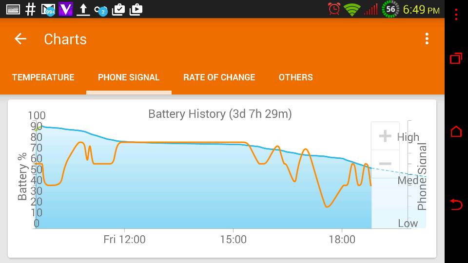

This and the long list of kworkers in your earlier post suggests that you have a low or fluctuating signal problem.
Someone asked that earlier, apologies if you replied and I missed it. Long week ok lol.
Anyway - if you go to the GSam graphs, you can see power vs temperature and phone signal, here's what I mean -

Thanks, I did not check it yet, but assuming you're right, how to solve it?
Depends on your needs and what carrier you have.
For example, if it's going in and out of 4G a lot and you don't need it all of the time, you may have a setting to turn it off. I think AT&T removes it though, hence, the carrier. And then just switch it on when best for you. I have a shortcut on my home screen for exactly that situation.
There are also apps that will control the radios when the screen is off. No one needs a 4G power draw in their pocket if that's the case.
