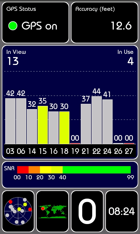

After reading this thread tonight, the first thing I did was download the program you mentioned and fire it up while in my living room, which is in the center of my house. My results? 13 sats in view 4 in use in less than 30 seconds with an accuracy of 27 feet. For being inside and at least 20 feet from the nearest window I'd say that works damn near perfectly to me.
But, I decided in the interst of fully testing I should do more. So I got dressed again (doubt my neighbors want me running around in the middle of the night in my underwear with my phone lit up) and went outside to test.
In the middle of my yard, I still see 13 sats, still have only 4 in use for some reason but now have an accuracy of 12 feet. 12 feet is not even half the width of my driveway so while it is about half as accurate as your 6 feet definition of perfect, I'm gonna still go with mine being damn near perfect.
Perhaps if I had let it sit for a minute or two it would have gotten closer to the magical 6 foot mark, maybe I'll try that in the morning.. Anyway, I took screenshots as well just in case anyone needed to see it for themself.

Your test results are some of the best I've seen. Thank you for posting your results and screenshots. Nice work! :)
