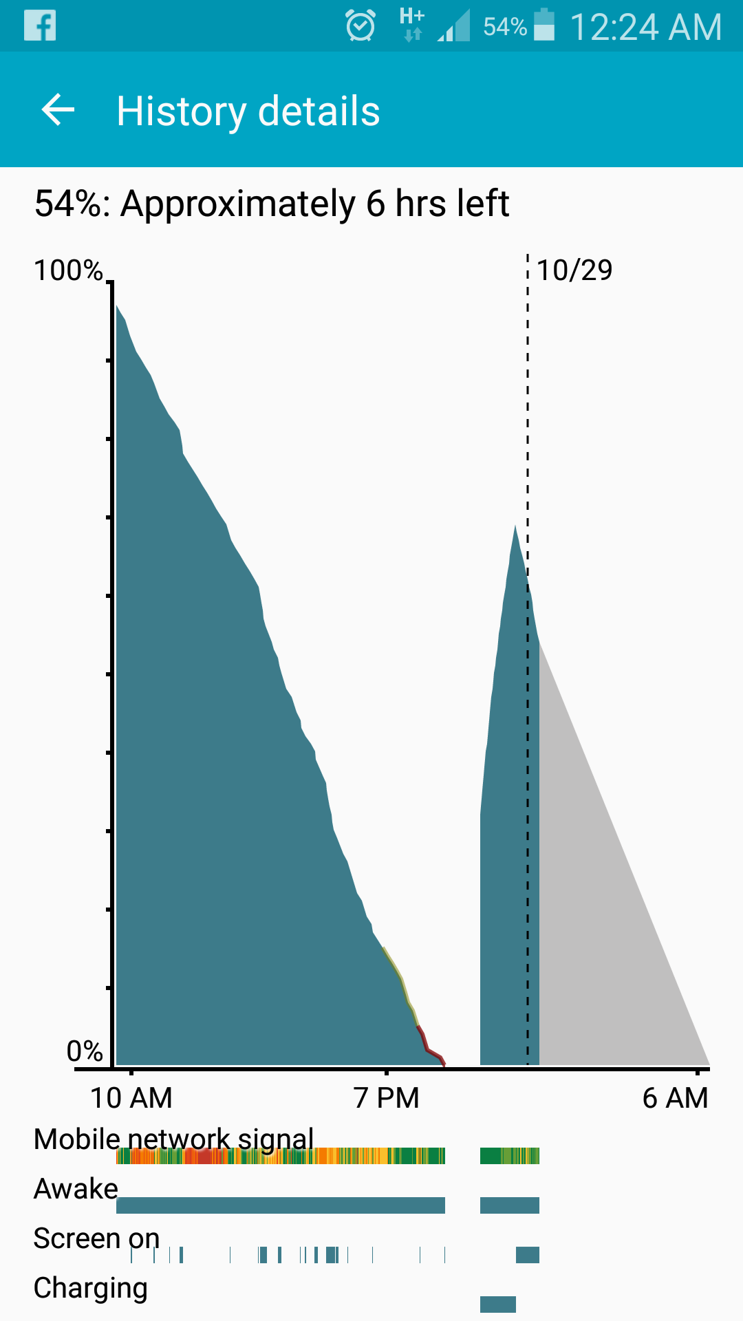

i do nothing on my s4 and its awake while screen is off . plz check the image i uploaded

i do nothing on my s4 and its awake while screen is off . plz check the image i uploaded it shows awake and screen shows off .

The awake line is not gone while screen line gone when screen is off
