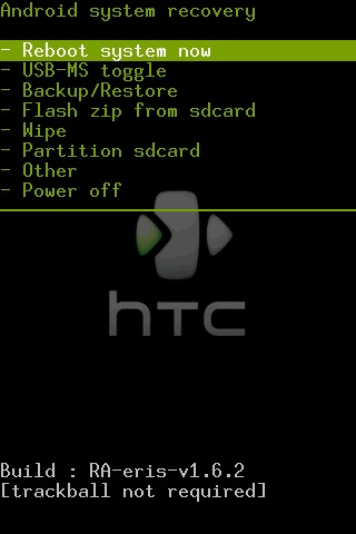

Okay guys, we've seen lots of reports of people whose Erises (Erii?) have or are starting to have trackball issues and are unable to properly navigate through Amon_RA's custom recovery. Well, I've been trying to figure-out how to tweak Amon_RA's custom recovery to work without relying on the trackball.
Anyway, after a lot of thrashing about, and with some sage guidance from Amon_RA, I was able to modify and recompile Amon_RA's 1.6.2 Eris custom recovery to allow an alternate set of keys to be used in lieu of having / needing to use the trackball--not just for scrolling, but for selection / confirmation! I left-in the support for using the trackball so that it will work either way.
Here's the new, alternate key mappings:
Code:
[FONT=Courier New][B][COLOR=blue][SIZE=3]volume-UP[/SIZE][/COLOR][/B]:  [B]scroll-up[/B] (trackball scroll-up still works too)[/FONT]
[FONT=Courier New][COLOR=blue][B][COLOR=green]green[/COLOR] [SIZE=3]Call button[/SIZE][/B][/COLOR]: [B]scroll-down[/B] (trackball scroll-down still works too)[/FONT]
[FONT=Courier New][COLOR=blue][B][COLOR=red]red[/COLOR] [SIZE=3]End/Power button[/SIZE][/B][/COLOR]: [B]select / confirm[/B] (trackball-press still works too)[/FONT]
[FONT=Courier New]The [COLOR=blue][B]volume-DOWN[/B] [/COLOR][COLOR=black]key,[/COLOR] which is used to take you back to the prior[/FONT]
[FONT=Courier New]menu / screen, remains unchanged.[/FONT]
Here's a screenshot of the new version: View attachment 13309
Notice the [trackball optional] (or [trackball not required]) text at the bottom of the screen under the "Build : RA-eris-v1.6.2" line that lets you know you are using the new, alternate version.

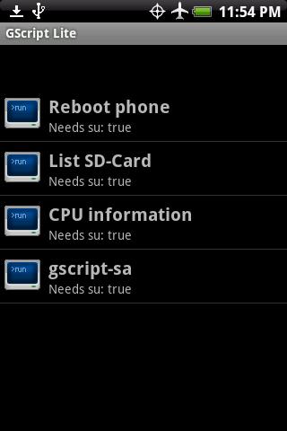

D. Launch a new Gscript Lite app instance and do the following:
Code:
[FONT=Courier New][B]Launch[/B] a new [B][COLOR=blue]Gscript Lite[/COLOR][/B] instance and:[/FONT]
[FONT=Courier New]A. [B]press[/B] the soft menu button[/FONT]
[FONT=Courier New]B. [B]select[/B] [B][COLOR=blue]Add script[/COLOR][/B] option (lower left)[/FONT]
[FONT=Courier New]C. [B]press[/B] the [B][COLOR=blue]Load file[/COLOR][/B] button[/FONT]
[FONT=Courier New]D. [B]select[/B] the [COLOR=blue]gscript-sa.sh[/COLOR] script[/FONT]
[FONT=Courier New]E. leave the [B][COLOR=blue]Needs SU?[/COLOR][/B] checkbox checked (you need root for [/FONT][FONT=Courier New]the flash to work)[/FONT]

[FONT=Courier New]G. you'll now be returned to the main Gscript Lite menu and you should[/FONT]
   [FONT=Courier New]see [COLOR=blue]gscript-sa[/COLOR] available at the bottom of the list of scripts[/FONT]

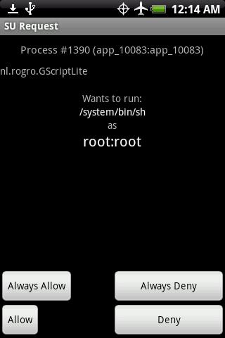

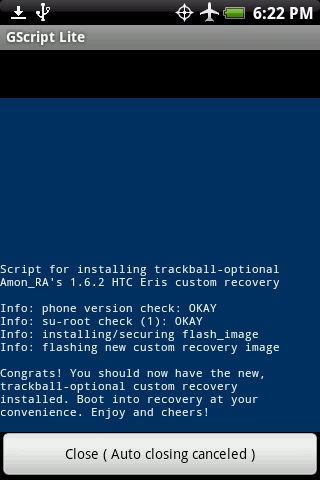

[FONT=Courier New]H. to run the script, [B]short-press[/B] the [COLOR=blue]gscript-sa[/COLOR] script name[/FONT]
[FONT=Courier New]I. you should be prompted by the SuperUser whitelist app to allow[/FONT]
   [FONT=Courier New]the Gscript program to run the [COLOR=blue]/system/bin/sh[/COLOR] as root ([B]select[/B] [COLOR=blue][B]Allow[/B][/COLOR])[/FONT]
The screens should look like this:
View attachment 13501 View attachment 13502 View attachment 13555

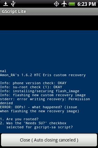

If you are not rooted, didn't enable the Needs SU? checkbox, or there's a problem flashing the custom recovery image, you'll see something like this:

E. Reboot into recovery to enjoy your new trackball-optional custom recovery! ;)

6. After the flash, press the volume-DOWN key to enter HBOOT. From HBOOT, press volume-UP to enter your shiny-new custom recovery.
