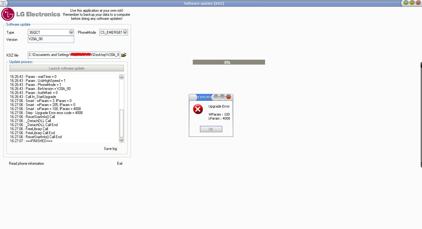

I was trying to update the software on my LG GT540 with the LG Mobile Support (from the official web page)..but it stopped on 4% and now my phone does not work.
I tried to update it with KDZ afterwards but I keep getting the same error..(attachment)
Can someone please help me? Thanks..

Are you able to put the phone in download mode?

Okay, download THIS KDZ updater xda-developers for this one you dont need windows enabler. First install MSXML 4.0 SP3 Parser (msxml.msi), second open the KDZ updater and make sure that the type is set to 3GQCT and the PhoneMode is set to DIAG, then browse to the .kdz update file, switch on the phone and connect it to the computer, then click Launch Software Update. IF it doesn't work, switch off the phone and hold the Volume Down button while powering on the phone, it should say on the screen Emergency Mode then connect the USB cable and let the necessary drivers install, once thats done, open the KDZ updater and change the phone mode to EMERGENCY, then browse for the update file and launch the software update. It should hopefully work :)
Did you disable "LGE Android Platform USB Modem" in device Manager???
If that's the LGE virtual modem then I have.
