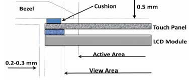

There are foam cushions separating the LCD and the Glass. The screen is not one piece. It will move a little bit -- it's expected when you have squishy material under it!

Here is a graphic showing what a typical capacitive touchscreen looks like. If you press on any surface near the boarders, you will see some play. It's not an indication of your screen FLYING OFF. :)
Now, if it's raising above the bezel, then it might be a problem. Also, if it is simply pressing down and coming back to flush -- if you keep fiddling with it, you just might find yourself experiencing a self-fulfilling prophecy.
Edit: note that the EVO has no bezel. It is flush with the edge of the enclosure. If it had a bezel, no-one would notice the squish, the light leak, and no screens would be coming up.
Now, if it's raising above the bevel, then it might be a problem. Also, if it is simply pressing down and coming back to flush -- if you keep fiddling with it, you just might find yourself experiencing a self-fulfilling prophecy.
I do feel this issue is not as prevalent as people suspect. If your screen comes UP past the bezel have it checked out. Otherwise, what you're experiencing is NORMAL
Thank you for this.
I agree that we are blowing this way out of proportion.
