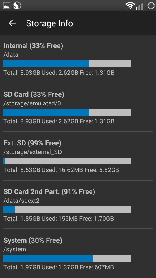

I'm using ART... I've noticed absolutely no difference in my storage. 188 apps, 77 of them user apps, many of which are large games.
It's running well, apps certainly load faster.

Okay, that is weird. On ART, where I've had it parked for months, it said 1.16 of 3.91GB available, with 115 apps, according to them. After switching back to Dalvik, it says 2.11 of 3.97... that's quite a difference. Needless to say, I'm leaving it parked at Dalvik for the new time being.
Yep.
With Dalvik, apps are compiled when loaded and stay that way as long as in ram.
ART compiles everything ahead of time, as scary said, and saves the compiled versions to your app storage.
So with Dalvik, I can have two hundred apps, available as fast as they can be read. With ART, the apps will be instantly available, but I can only have a hundred of 'em.
Not seeing an appreciable difference in performance and taking a monstrous hit in storage when using ART, I can't help but stay with Dalvik, even though it seems inexplicably wrong.
