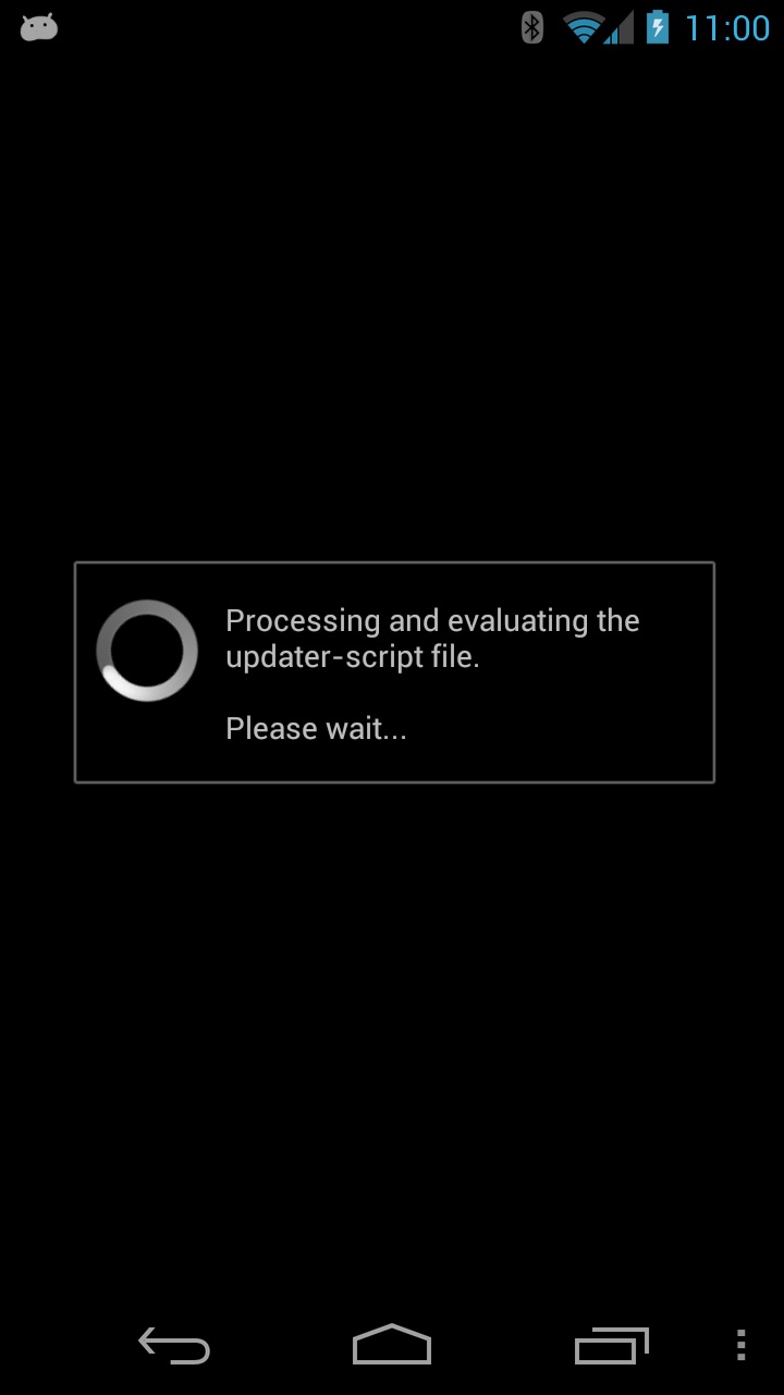

Screenshots:
The OTA Verifier app can be used to evaluate an over-the-air (OTA) update.zip or other flashable .zip file before you attempt the install or afterwards to help you figure-out why the installation may have failed. OTA Verifier will point-out what files and conditions are being tested so that you can more easily attempt to correct these issues.
Play Market Link (free!): OTA Verifier (beta)
Do I have to be rooted to use this?
No, but rooted devices will have more conditions that the app will be able to test/evalute because it will have access to protected files that non-app devices don't.
Will the app actually do the installation or change anything on my device?
No. The app will only evaluate the expressions and conditions contained inside the updater-script file inside the .zip file that's trying to be installed. None of the functions or commands that try to modify your device (i.e., delete/patch/format/extract, etc.) will be evaluated or executed. The app basically operates in "read-only" mode with respect to the .zip file being evaluated.
Will this app work on older devices or flashable .zip files that use the amend update-script files?
No, this app evaluates and interprets the newer edify updater-script files (notice the "r" in "updater").
How do I use this app?
- Install and launch the app
- Click the "Select File" button and navigate to desired .zip file
- Long-press (press and hold) the file entry for the desired .zip file
- Click the "Verify OTA .zip" file pop-up
- Wait for the app to process the file (should take under a minute, depending on your device)
- View the displayed results (text will also be copied to the clipboard)
