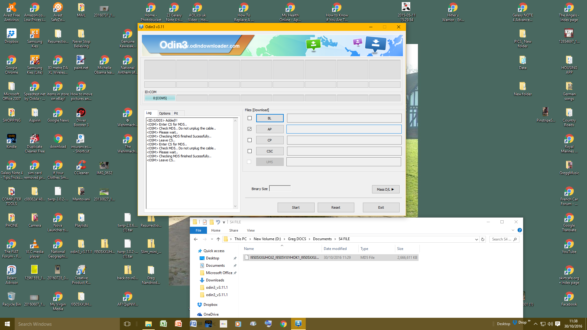

Got the sammy file downloaded and extracted. Odin 3.11.1 extracted.
Power, vol down and home buttons held. When the download screen shows on phone, I push vol up to go into download mode. Connect phone ( tried it with USB 2 and USB3- no difference). Odin then shows ADDED in blue. As soon as I try to drag md5 file to AP box, it starts an ENTER CS for MD% check- as screenshot.
And that is where sod all happens. No way will AP box let me copy the tar file over. I have got to be doing something wrong.

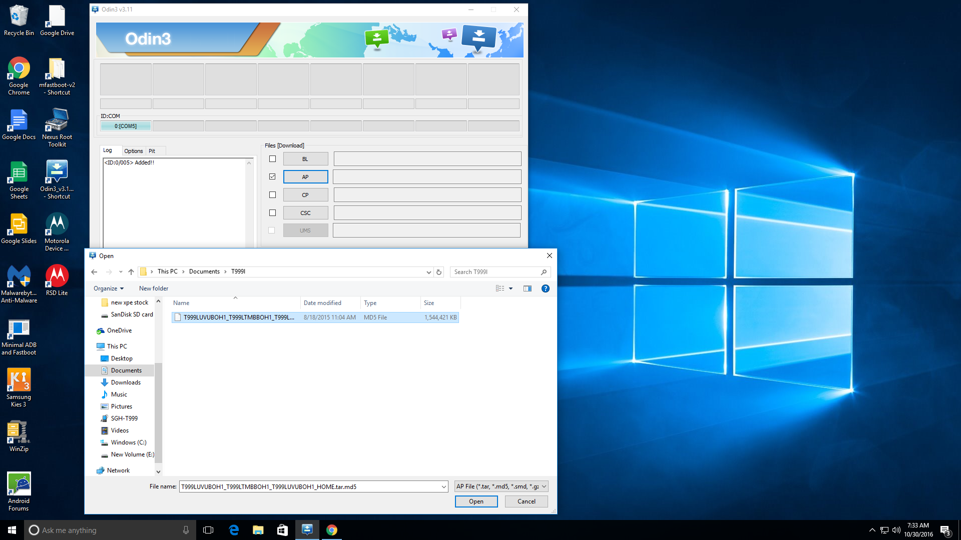

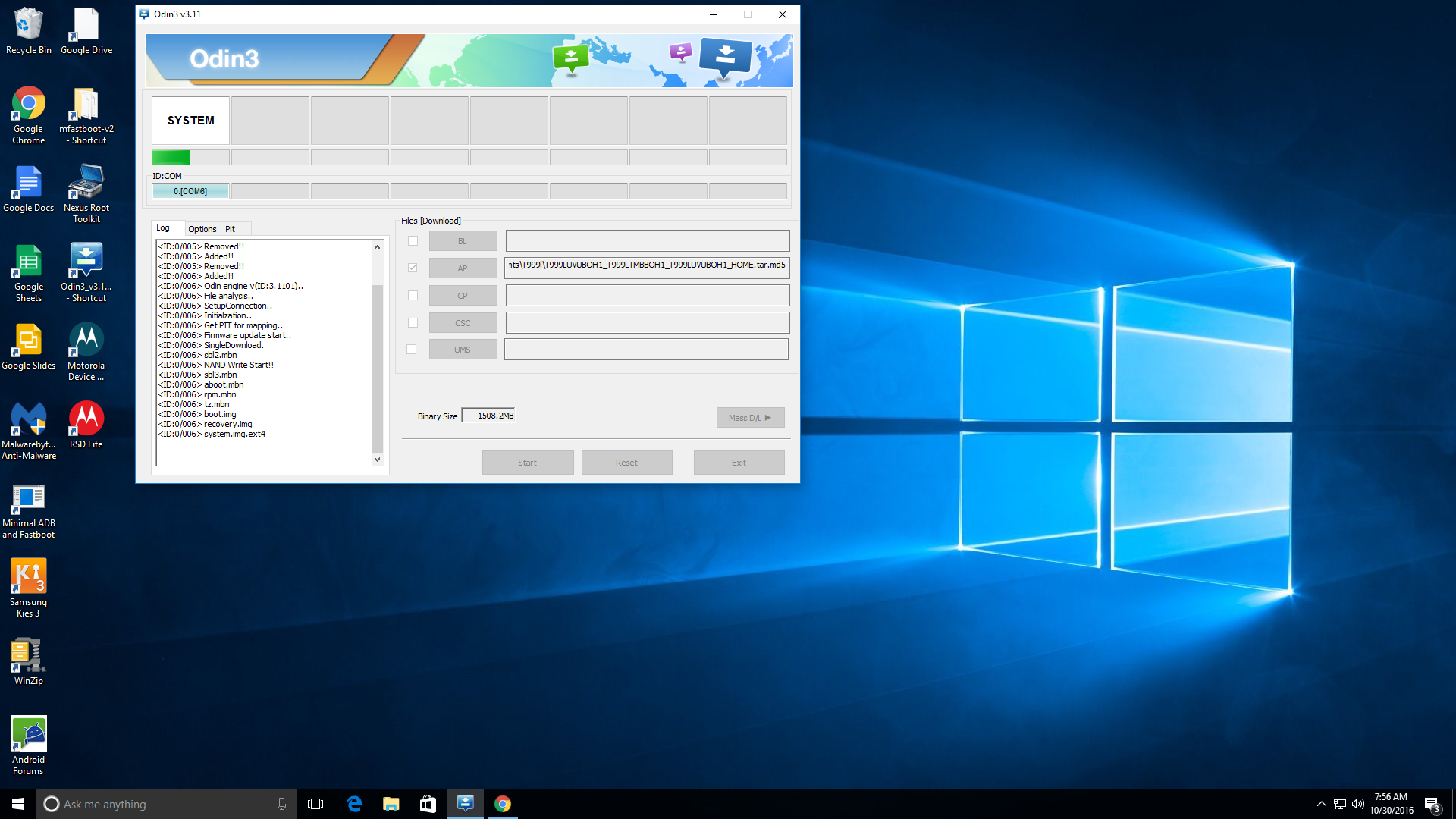

When you check the box by AP, also click on the AP box to get it to open and be able to navigate to where you have the file and select it.
