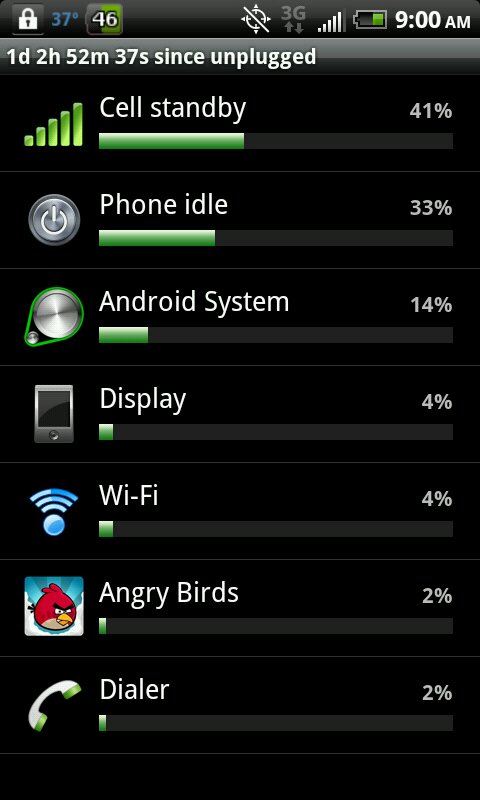

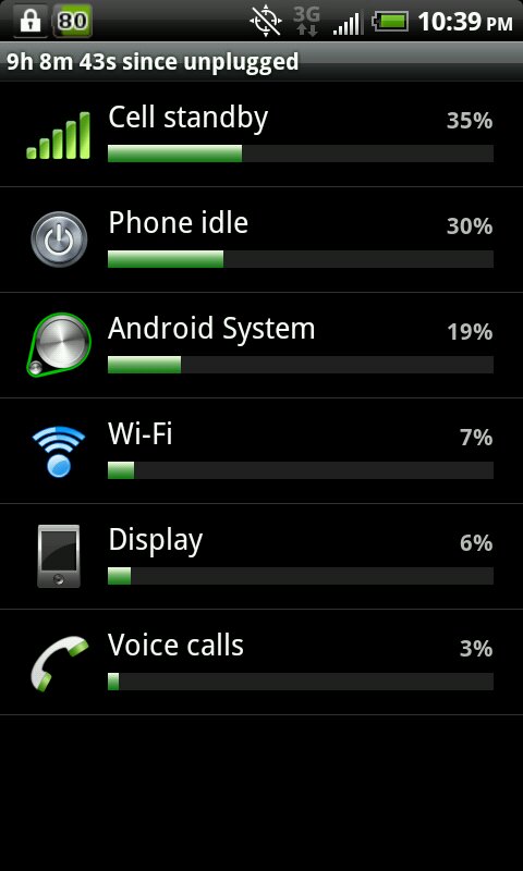

Attched are two battery life screenshots.
One at about 9 hours unplugged and another at about 27 hours unplugged.
