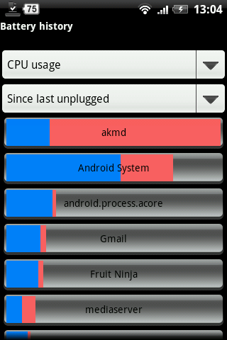

Try this.... charge it up fully before bed, unplug and leave it overnight as normal, and in the morning enter *#*#4636#*#* in the dialer. When the test menu opens select "Battery History" then "CPU usage" + "Since last unplugged". This will show the most likely guilty process.

Bingo! Turn it back on and see how things work out.... I'll bet that it's the akmd process that's been hogging the CPU and hammering the battery. I don't fully understand why this occurs on some handsets but the accelerometer/compass daemon has been fingered as the culprit.

Slug :D man , if this is the case . You have some link to some details? Btw if you remember I told you having this trouble. I used the alankila driver on ele, and it seemed to work. akmd was not there :P
oh one nice picture :P (its kinda screwed since I am charging :P . but looks nice) btw its just for ilustration since I think this is since I flashed the rom. or I dont know :)

It makes no odds here either, but several users have found that it cures this issue of akmd hogging CPU cycles. As yet nobody has been able to pin down the conditions required to replicate it though.
