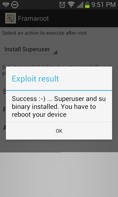

If you use Framaroot ( can be found http://forum.xda-developers.com/showthread.php?t=2130276 ) which I think is the easiest method to root without a computer, use the last option (Aragorn) exploit. I have tested my self and works on (GCO1). For (ICS) you can use the second option (Frodo) exploit. If you want to Unroot your device there is an option on Framaroot to unroot your device as well .
