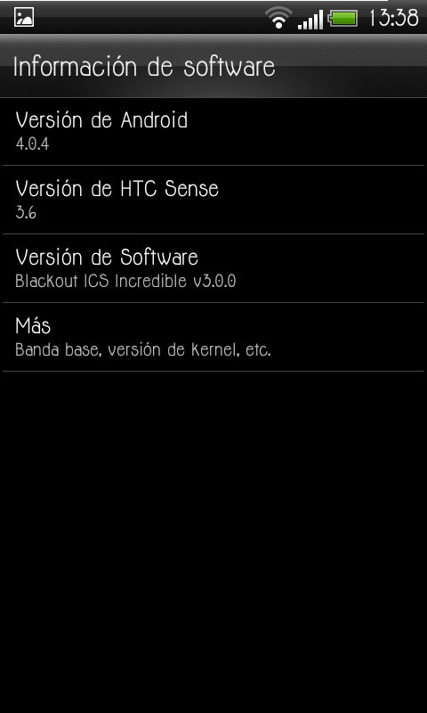

I think this is one of the more promising Sense ROM's available for the Desire HD so I decided to start a thread to consolidated questions, tips and tricks regarding this ROM.
What is Blackout ICS Incredible v3.2?
Blackout ICS Incredible v.3.2.0 is a Android 4.0.4 ROM with a Sense 3.6 interface ported from the official HTC ROM for the Incredible S. You can download the ROM from this link.
Does is it work?
The ROM is good enough to be a daily driver but there are a couple of issues:
