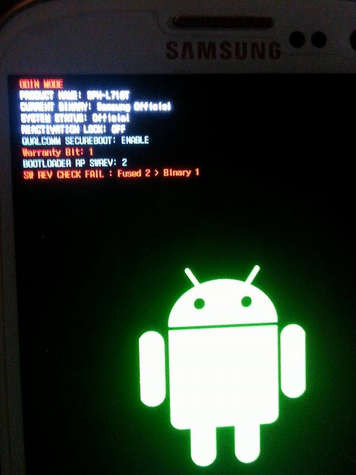

would like to point out that if you take the new update (L710TVPU0AOF2_L710TSPT0AOF2_L710TVPU0AOF2_HOME.tar)
you will not be able to flash a custom recovery ...... any help would be appreciated

Yes i tried both recoveries and after updating to the latest firmware AOF2
U can not use any version of odin to flash recovery..... guess im stuck with a non rooted phone for now.... i also tried nf4 and AO3 .tar also and nothing works... will not let me downgrade either
Have you tried to Odin your stock tar
yes u can not flash nothing in odin

the latest firmware is not AO3.......its AOF2
and it will stop you from flashing a custom recovery STAY AWAY FROM (AOF2)

Im not sure we are understanding each other ...i am running (AOF2) and philz can NOT be installed
i have been trying all night....
