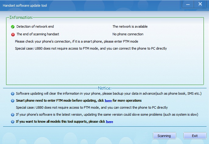

I installed ZTE Warp Nandroid RC2.zip now by reinstalling CWM. "Thanks AndroidxD" How do I use the -handset software update tool- to go back to stock recovery and stock android? It asks for FTM mode and with Nandroid installed it goes to CWM so how do I make handset software update tool work because I can't enter FTM mode? I have tried Woodstock's suggestion using -dial *983*87274# on your dialer and choose "only Diag"- Does not work for me. I can press "only Diag" it scans for phone and says I need to enter FTM mode. So what do I do?

Flash stock recovery back the same way you flashed CWM recovery. If you download the installer I made it has stock in there also just choose it. ZTE Warp Recovery Installer V2.zip
Then you will have FTM mode again.
