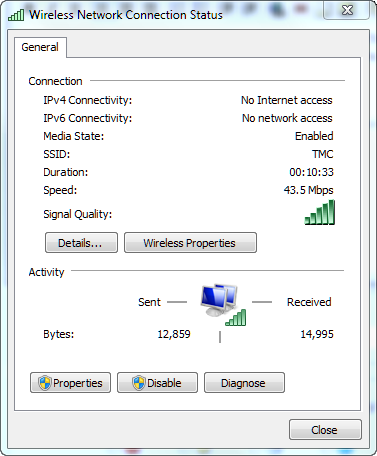

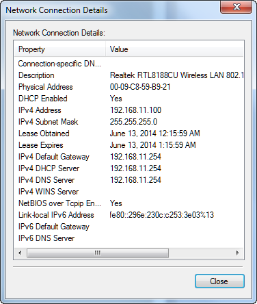

It did not change the problem on not connecting to internet. Here are 2 screenshots showing connection...................
You may also want to go into your wifi settings and disable these..... Network Notification, Always allow scanning, and Smart network switch. If you have Connections optimizer on then you may also want to disable it.
Wifi hotspot apps can be tricky. Settings that you think wouldn't have anything to do with them can cause issues.
In the app instructions on Play it has this ....
*** If you have problems with Android 4.3 / 4.4, be sure you have DISABLED (unchecked) the "Scan always available" option following path: Settings -> WiFi -> Advanced -> Scan always available ***
If you have purchased the app WiFi Tether Router, they have full email support. Use it if needed. The app has a 4.5 out of a 5 star rating on Play. That says a lot about the app. ;)
