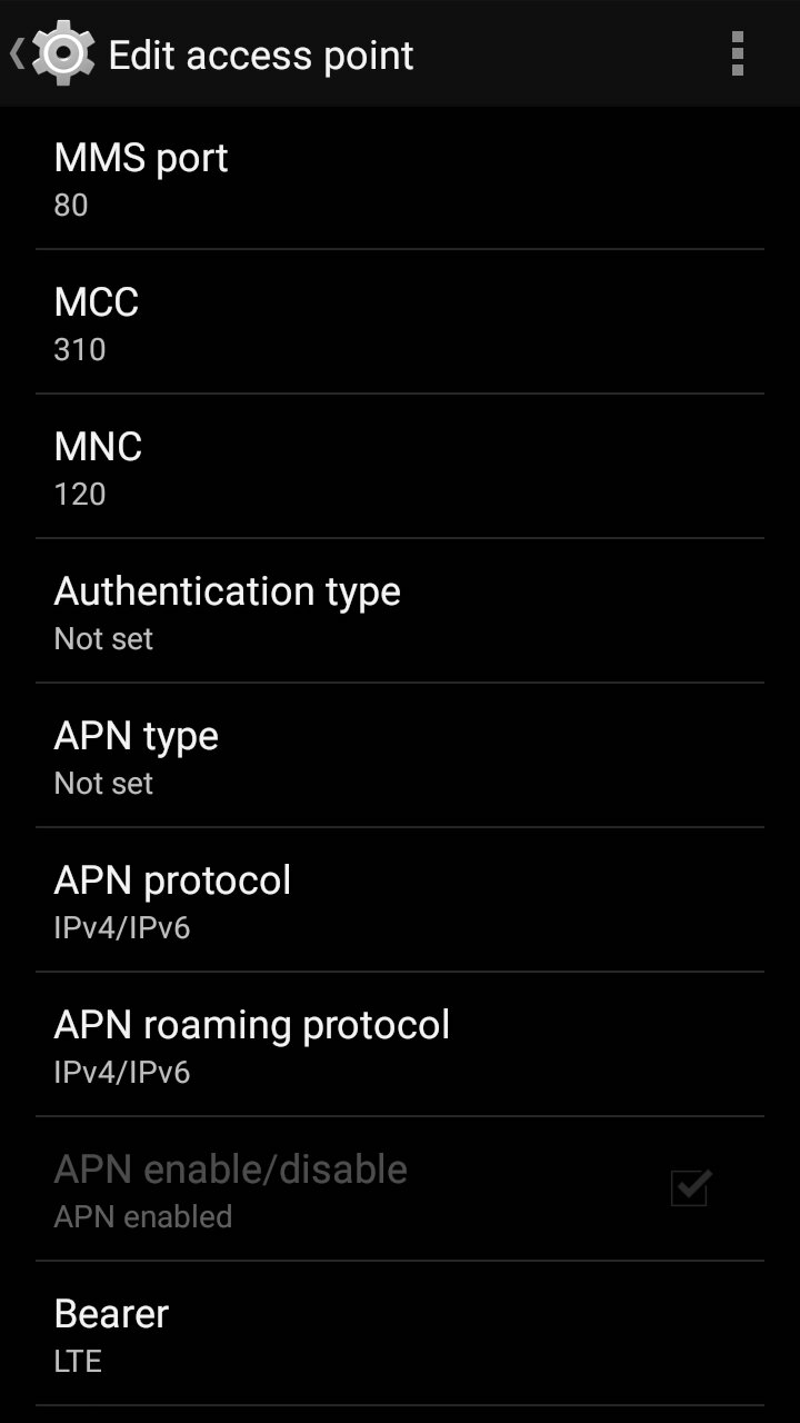

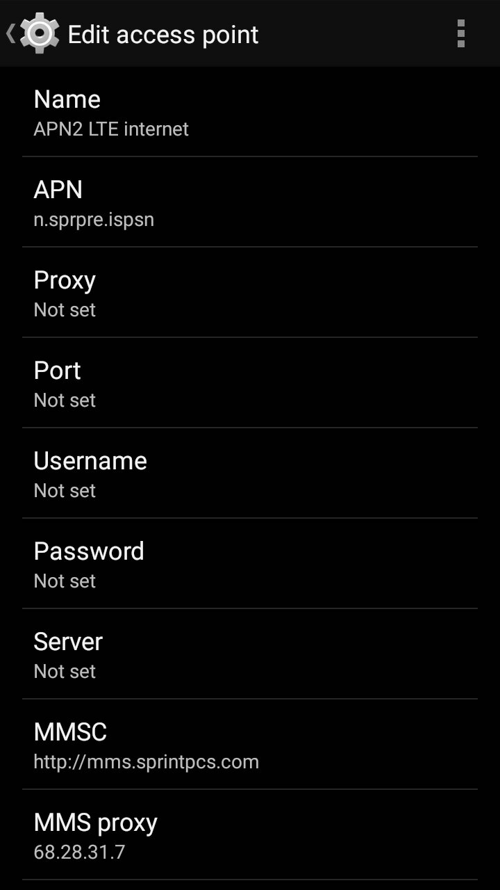

Well I tried it and everything worked but data. I think I am going to start testing for them so hopefully there will be a fix. Some are saying that its working though.
Data has worked for me when i added a certain apn(as stated before). I have sprint as well. I have been on liquidsmooth 4.4.4 for a while now and havent had any problem for the past few months especially now with that kernel rotation fix. Have not tried adding the apn to a lollipop rom but you could give it a go if you have not already. Make sure after you add an apn you let it sit/reboot.
