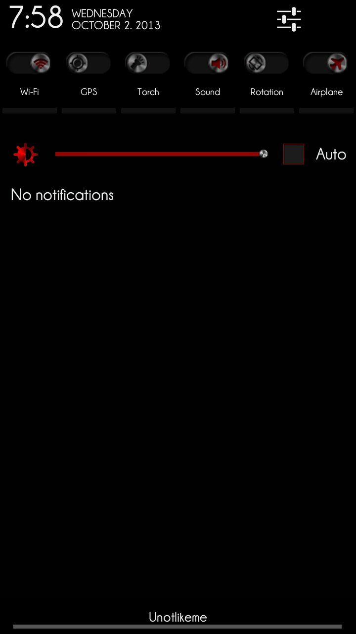

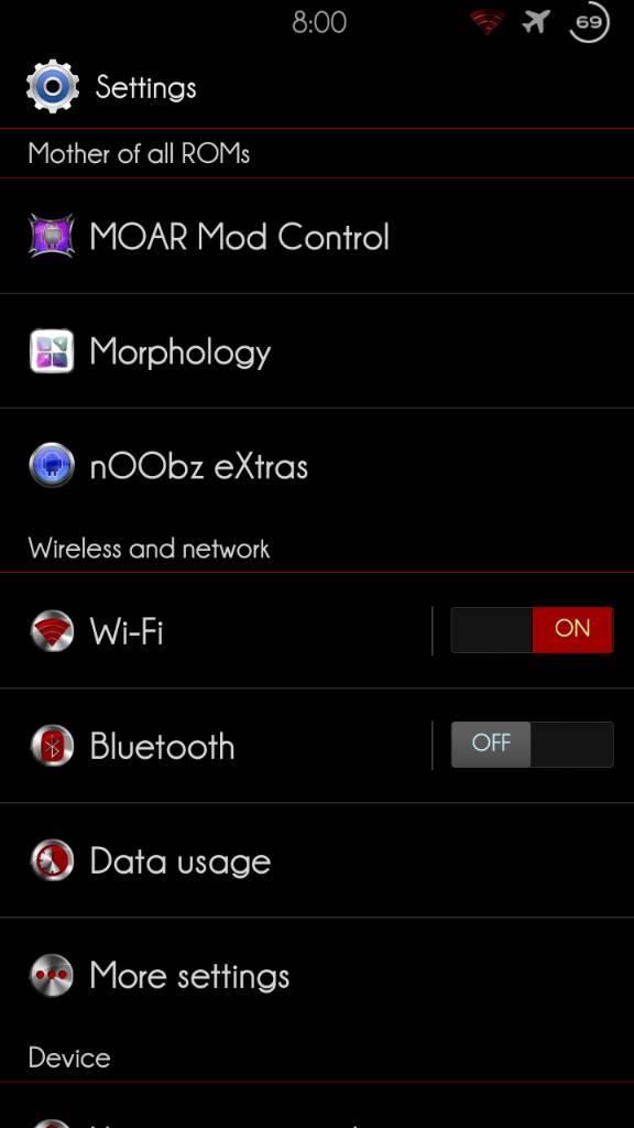

I've been using the Red Magnum theme! I also figured out the toggles color problem. I just started messing around with stuff what's the worse that could happen I have a backup! Lol Check this out! :cool: added home screen cool wallpaper I found that matches the theme perfectly! I also found a cool iron man.gif that I turned into a boot animation. How can I send it to you biker? So u can post it in this thread.
