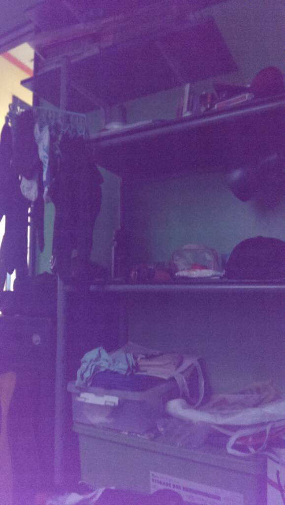

Does anyone get this colouring at the bottom of the picture?
It only happens in low light conditions and sometimes it's pink. Even in Night mode I get it.

Any known fix for the "pink tint?"
sending a trouble ticket directly to HTC will ensure this "issue" gets to the right eyes. this is not an htc support forum and they do not read any issues or concerns about their devices here. :)

Yes, this is a huge problem with a large percentage of HTC One phones. If you take your hand and put it in front of the lens or put it face down on a table, the screen most likely will not be black. It will be either blue or pink. It kind of goes away at a low ISO setting like 100, but gets progressively worse as the ISO number goes up.
I read in a few places that HTC is aware of the issue and they say that it should be addressed in the 4.3 update.

I still have to do some testing of it, but I think there might be something wrong with one of our phone's cameras in low light. My wife and I each bought a One. I got silver and she got black. We both have the same updates. We were at a wedding and both taking pictures. The reception was outside and it was starting to get dark. Her pictures were horribly grainy. Mine looked fairly good. As far as I can tell, both phones are using the same settings. If I set them both for night mode, it really didn't help her photos. The difference was quite noticeable. Daylight pictures on both phones look great, it is only low light pictures that she has a problem with. I haven't tried doing a factory reset.
After updating to Android 4.2.2 my camera has been experiencing purple/Pink hues during low light situations. Has this been fixed in the 4.3 update? I'm using stock 4.2.2 default camera app, not rooted.

already documented earlier in this discussion. happened prior to the update.
send htc a trouble ticket. the more tickets issued, the more htc will make it a priority in a possible future update.
