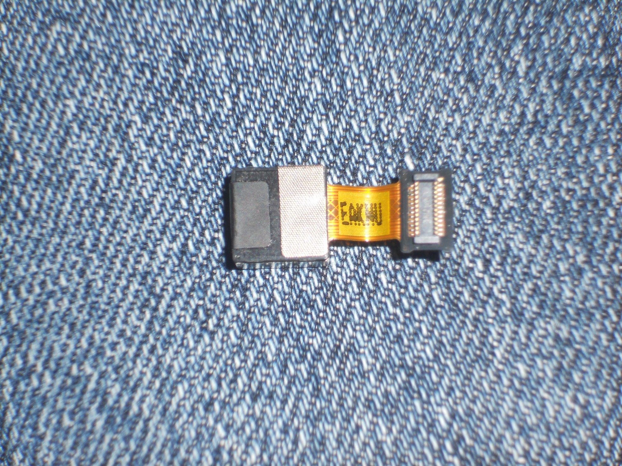

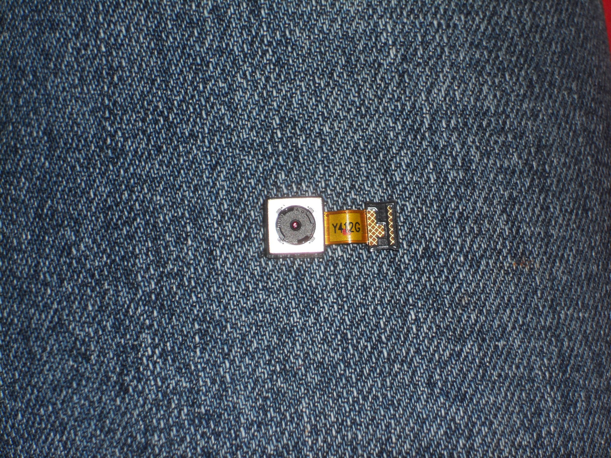

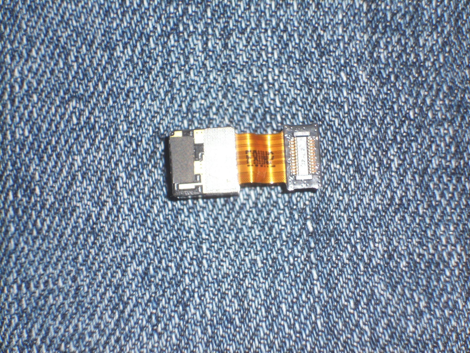

These are the two cameras, front and back images. The top camera is plagued with the green tint, while the bottom camera sees everything just fine. Obviously, they're two very different pieces of hardware.

Alright, so the top camera, which is infected with the green tint, says "Y495B", and says "LGIT" and "1414" underneath. On the flip side of the flex cable, it says "E4QMP".
The working camera says "Y412G" on the front, and "E8BMN" on the other side of the flex cable.
And for those of your who were wondering, yes, swapping the cameras does produce the desired results. My daily driver phone now has a working camera, meaning I don't have to carry around my Moto E with me wherever I go if I want to use Snapchat :P

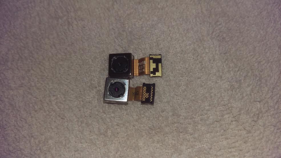

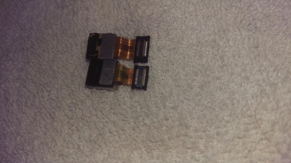

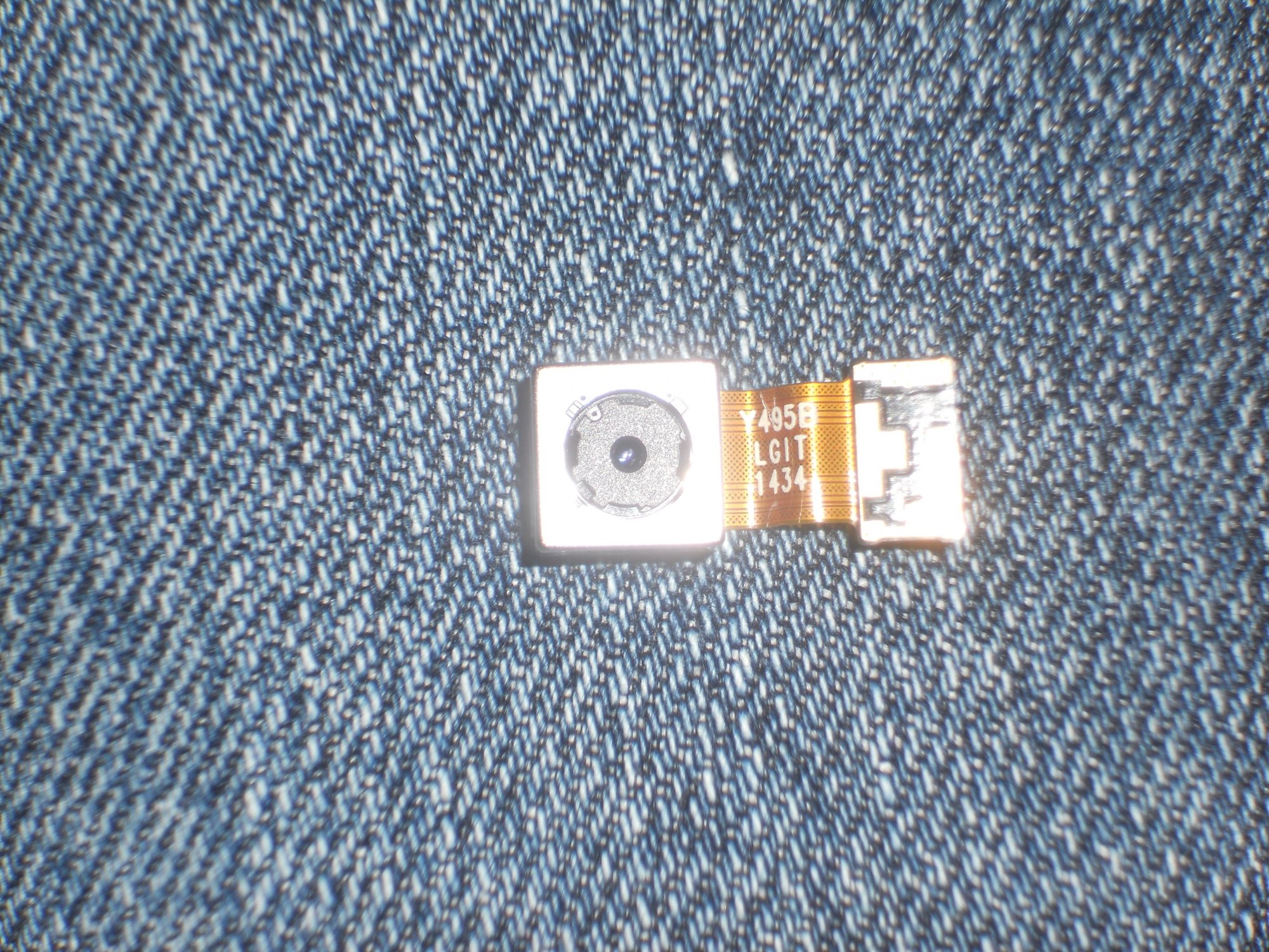

@Ph0enix_216 pictures I got. Gf hooked me up with a boost Lg volt decided to open it up; before so I rooted the phone I got and tried some roms and camera worked great. Now I have a VM Volt with working camera. Thanks a lot for this post it helped a lot! got you some pictures about the cameras, don,t know if they will help.
**Swapped them today.
