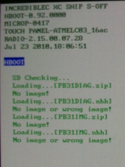

Okay, need some help. I am admittedly a newbie to flashing ROMs and stuff but I feel like I have done my due diligence to solve this problem and can't.
History: I am rooted, currently running MIUI 1.11.18, radio 2.15.00.07.28
My main issue is this: when I try to get into recovery mode either by holding volume down+power or reboot into recovery from ROM manager, I can get to the HBOOT white screen, but when I scroll down to recovery, it kicks me to FASTBOOT. When I then select recovery, it kicks me back to HBOOT. After that it will flash up the message in the attached picture.
attachment.php
I think this all started when I was trying to flash the redemptive rEVOlution 2.3 ROM and it said to flash HBOOT .92 (which I think I already had but didn't realize). It was named PB31IMG.zip, and the text that flashes up seems to have something to do with that. I tried deleting that zip from my SD card which didn't make a difference, then re-downloaded it so it was back, and it still didn't matter, same result. Flashing any other ROM doesn't work because rebooting in recovery doesn't work to be able to "install from sd".
Any help to be able to get back to recovery would be helpful. Thanks

Even tried to do a factory reset, but that didn't even work. It didn't reset anything, its as if I just rebooted...
Strange. Any help or suggestions appreciated.

Sounds like you just need to reflash recovery using ROM manager. Check the options in the settings to erase recovery before flashing, and then flash it a bunch of times.
^^What he said. Delete the PB31IMG file off the card, you don't need it anymore and it will try to reload unnecessarily while in hboot.
That did it! Thanks so much guys. I selected the option to erase recovery before flashing, flashed it twice, reboot, voila!
