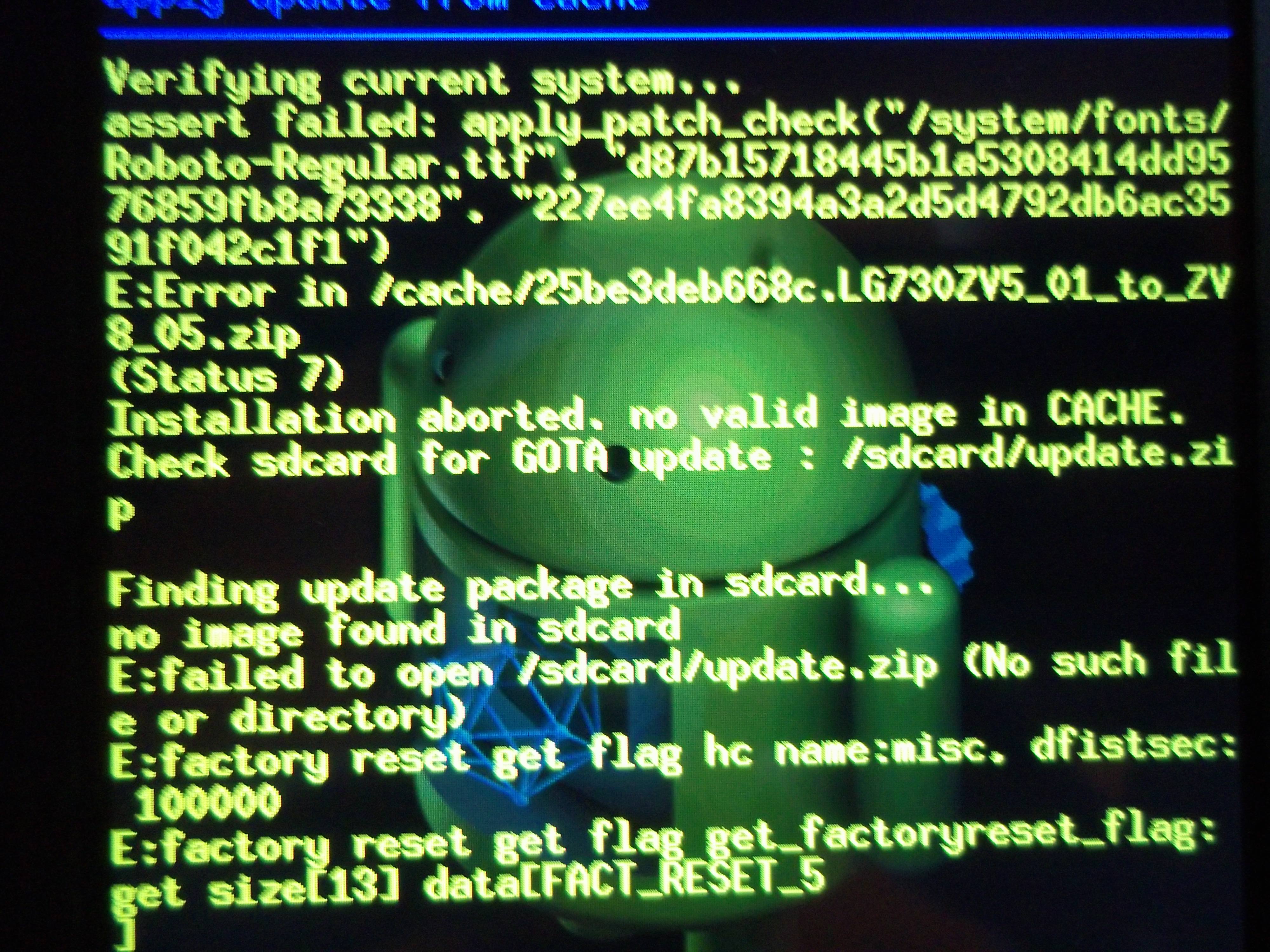

I've been trying to update my phone to jellybean for weeks now with no luck. I finally took a picture of the screen I keep getting. Any help would be appreciated. Thanks!!!

I first tried ota a few times but it never works. Then yesterday I tried the way you suggested 3 times or more. Each time I got an error message saying I don't have LGMobileDL.dll on my computer. I'm beginning to think i just need to buy a phone with 4.1 already on it. :confused:

Wow. OK. I would try uninstalling all lg drivers, rebooting and reinstalling the drivers again. Make sure you follow all steps in the flash process, did you skip something by accident? Perhaps try a different PC if possible. I've never had that particular problem so I'm at a loss when it comes to a quick fix.

Did the above real fast this am but didn't work. When I get home today I'm going to try again from my other computer. Thanks for the advice.
or you could just stick with ICS. The jellybean update for the Venice is horrible and will likely start causing other issues. "Downgrading" back to ICS was one of the best things I've done with my phone.
Your are not on complete stock. Go back to fully stock ICS no edits whatsoever. The script is basically saying you changed something with the font.
