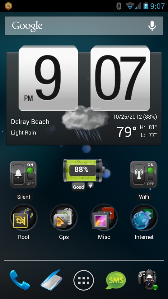

By the way screen shots do work, figured it out, and also I took a quick shot, I really didn't have much time to play tonight, but did a quick set up, will play a little more at work with it tomorrow. I did notice signal on WiFi is not that great and I am only 15 ft away, LOL

What are you using for your widgets and icons? It looks really nice. Also, I haven't had enough time to really play with a non-sense rom yet, How did you use the sense clock? When I flashed I only had the one crappy analog clock in my widgets that I don't like. Your screen looks super nice. I'm thinking about flashing and playing around with PA this weekend so I'd like some options! ;)
I'd love to know about the icons too :p I've yet to figure out how to change them yet.
