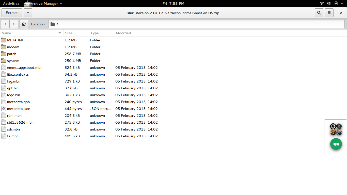

I could be mistaken, but for me that link downloads Blur_Version.210.12.57.falcon_cdma.Boost.en.US.zip. Which is the 4.4.4 update right?

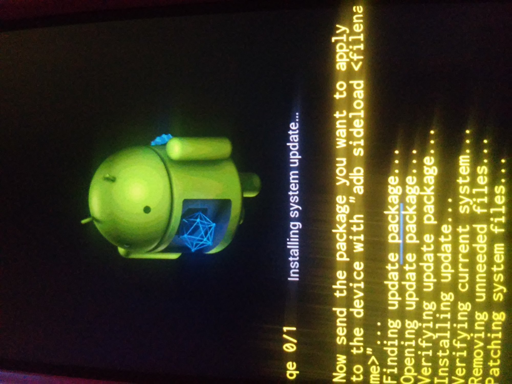

Installing....we will see.
*EDIT been here for a good while now.
**Double Edit not looking good
-radec
edit: I quoted the wrong post.
No, it is a different file name than the 4.4.4 update
So I tried flashing it while I was on a rooted debloated version of 4.4.4. stock and it failed. Flashing completely untouched stock zip, then stock recovery, and then will try again. Please let this work!
