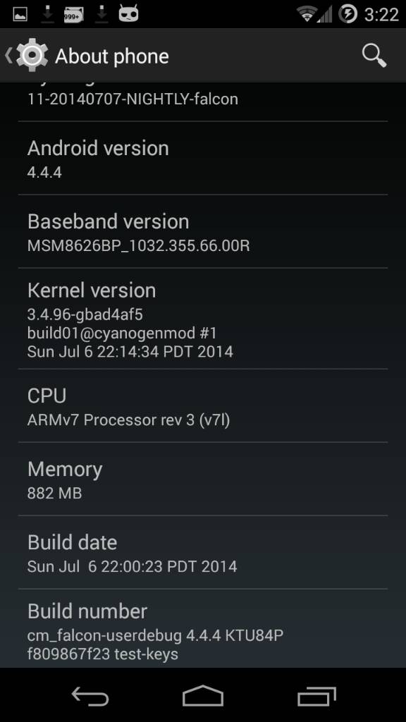

Thanks! It definitely works on the latest CM11 nightly's but I can't get it work on PAC. Oh well I guess, CM11 is amazing enough lol :D
This fix fails when I try to flash with cwm. I cannot send pictures via text "no APN specified on this device" error cm11 moto g boost mobile.

Please help I have no picture messaging lol no APN specified on this device....

Are you saying the flashable does not flash, or are you saying after you flash it you still don't have mms? I have not tried this on the newest builds of cm11 and they made some changes to the apn file that I have not looked at yet.
From the 7-9-14 nightly change log:
Network Settings: move APN to common area, both CDMA and GSM use this (android_packages_services_Telephony)

Flashable does not flash for me. Sorry about the double post. I'm new to this android forums app. It was a a mistake :(. Tried to flash it a few times. Even factory wipe reflash cm11 flash fix ,fix does not flash...... Thank you in advance.
Do you get an error?

I just updated to the newest version of CM11 and the fix still works perfectly fine
I seem to lose mms when I flash a different kernel (aero) on the stock or deodexed roms by super r. Would the new zip fix? I'm on Boost.
