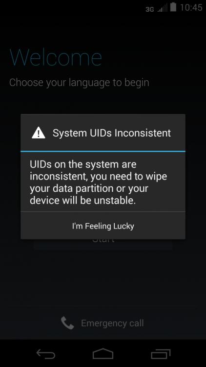

it says this once i boot up right after i installed the rom. it also says google search has stopped. Any help, please?
Are your partitions up to date? You can run the partition updater in the OP to be sure.
The google search may be stopping because you need to update other system apps. If you can get to the play store, try updating everything and reboot.

i got it to work! now you said i still have cwm if i skip the command you told me. Im in cwm. it has 4.3 installed just fyi. Can I install the partition updater and then your rom and hopefully it will work this time?
No, you will need to update to 4.4.2 first. The partition updater gets you from the the first 4.4.2 update to the second 4.4.2 update. You can update to the first 4.4.2, then flash the partition updater, then flash the rom.

Update to 4.4.2, flash the partition updater, then follow the instructions in the OP for flashing this rom.
the update removed cwm :( will I have to install both by fastboot then?
Fastboot cwm, then flash the updater and rom through cwm.
edit: or you can let the 2nd 4.4.2 update happen, then fastboot cwm and flash the rom only

I got the mismatched partition message too, but it works fine. If I remember correctly, you need to reboot into cwm from the fastboot menu right after flashing it. The menu is weird though. Use volume down to move to recovery, then volume up to select it.
it worked! and i installed this rom successfully with no errors, everythings cool! \(^_^)/ thanks sir! YOU THE REAL MVP. You've heard this a million times but thank you so much, my problem was solved!
