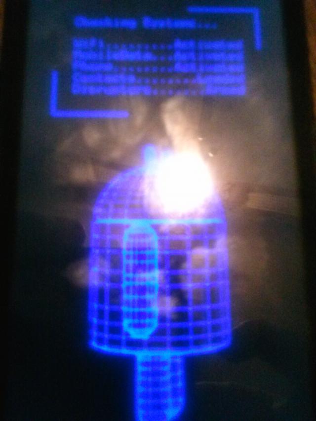

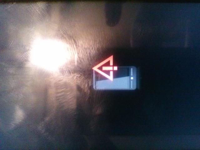

Hi I looked around and tried a few different things suggested, but I cant get it to work. I'll tell the story. I tried to root my phone, obviously, and got all the way to the end and (following a tutorial) went to put MeanRom on. Everything went as the tutorial said it would so I thought I did it right. Wrong. Now I have the spinning blue android that is in a continuous loop (I read somewhere it is eating a big bowl of boot loops). I tried the volume down/power button thing and chose recovery and it goes to a red triangle with exclamation point. I tried factory reset from that screen. Continuous boot loop. I found something that says when I get the red triangle to push power/volume up and I got into a screen with blue print. I was excited. I wiped cache, factory reset and reboot. Back to blue android. I seriously need some help :confused: Im obviously a bonehead so step-by-step would be appreciated since I am not sure what "flashing a ROM' etc.. mean... I know, I know, if that's the case, what am I doing trying ro root my phone in the first place? I have an Associates in computer programming and figured how hard could it be? Obviously, I knew just enough to be dangerous.... I have attached a few things to look at. Thanks in advance :D

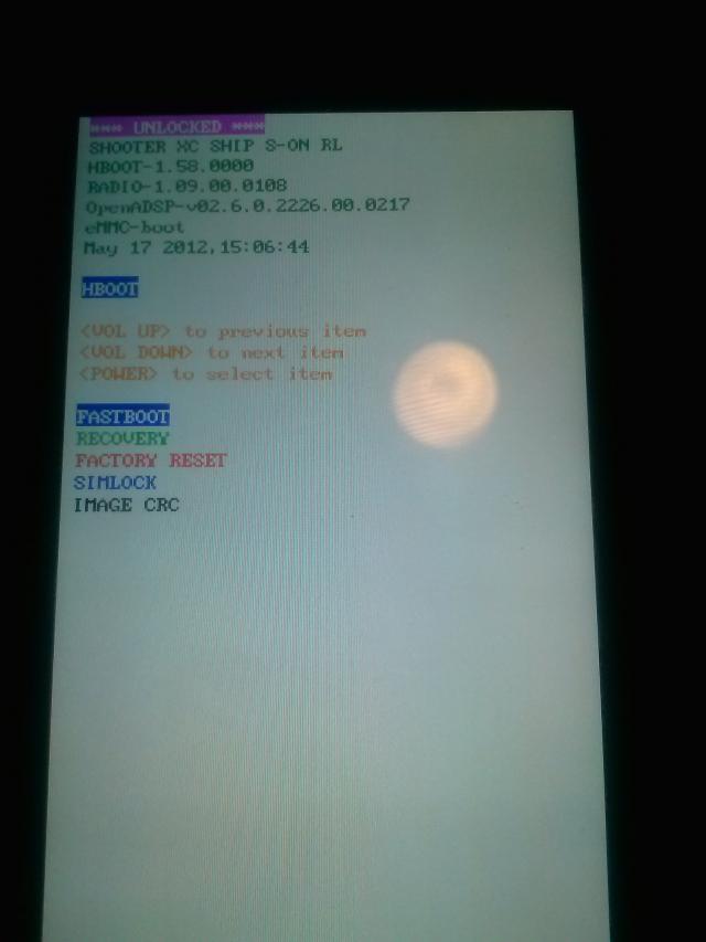

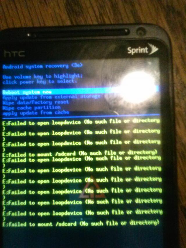

I am assuming the phone is still s-on? Once you are up and running you will want to install 4ext recovery and enable smart flash. Without that you will get bootloops when trying to flash a rom and have to flash the boot.img seperately.
You don't have custom recovery installed
You need to volume down + power to access the bootloader and choose fastboot. Connect to the pc with a usb cable.

Pull battery on phone and re-insert. Hold volume down and tap power. Continue holding volume down til you see the bootloader screen.
From there select "fastboot".
The phone should display FASTBOOT in red letters. Connect the phone to the pc. the phone should now say FASTBOOT USB.
