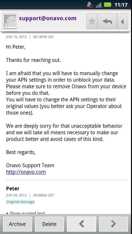

How do you change the APN on a unrooted Droid Bionic running the .905 update back to default values? An app kicked me off my data and the developers sent me this. Any ideas?
