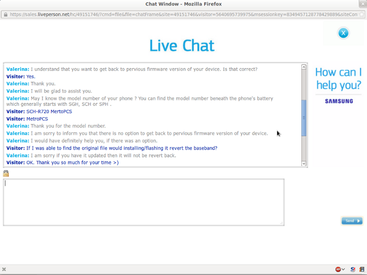

Hello. Once you install the software update it flashes the firmware for the radio. There's no easy way to revert back. Perhaps a dev may know how to flash old blob back but there's no layman's way. Reflashing the old software will not downgrade the baseband. I know on iPhony if you saved your blobs you can revert the baseband with a special program.
i remember changing some files around that someone posted here when i didnt have my data working in an attempt to get it back. and i changed the build prop and the entire system/etc folder and that changed the basehand to the one in the generic update EJ29 or whatever it was.
edit: i guess the only wway to actually change it would be to use the phone.tar in the return to stock thread in the acs forums by shabby. that changes the radio but then i would have the yellow triangle again... i already ran odin twice testing thing out. if only there was way to reset that counter like with other Samsung phones
