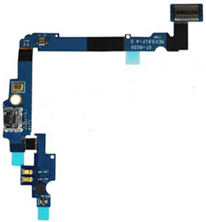

He,He, funny you should ask. you can get the charging port online for about 7 bucks and install it your self. There are videos on Youtube to walk you through it. I did mine yesterday (I don't have a Verizon version phone and they are different so order the right one and watch the right video) It was a lot easier that I thought, but you have to remove the mother board to get at it. I missed removing the volume switch and it tore the ribbon cable to it when I took off the mother board. If I was to do this again today, I would get it right. I was careless. It takes about 15 minutes tops to do. My usb port came with tools to help open the case but you really don't need them. I can buy a new ribbon for my volume, but it looks like it has to be soldered on the mother board. I will look into this down the road, but lets just say, I am getting rid of the gnex book mark on this forum and putting one in for the nexus 4. Ebay and Amazon have them, just get the one for the Verizon version of this phone if that is what you have.
Here is what it looks like:

Tim K fixed his and he gave me some tips. Just don't get sloppy like I did. I plan to buy a new ribbon and volume control (They sell them for 5 bucks) and see if I can get it working again, but for now, UPS tells me my N4 will be delivered tomorrow. Check out this link:

Before you perform surgery on your phone, have you tried using a razor blade or other thin object to pry the connector up? I had this problem with two of my GNex's, the first one I replaced through insurance never thinking I could replace the part myself, the second one I had read a post about doing the razor blade trick and it worked perfectly... and hindsight it probably would have worked for the original as well.
After doing some research I found that a common problem with the usb connector is the little connection board inside the port gets bent down over time... making it so you have to jam the connector in or hold it at a funky angle to get it to make contact. This can be remedied in most cases by simply bending it back up a tiny bit with a razor blade.
It's worth a shot, hope it helps.
I purchased the connector on Amazon Prime and a tool kit. It was incredibly simple following the iFixIt steps. My phone is charging great now... this isn't to say I haven't really considered buying a new phone... it just feel like it's time haha ;) Plus, my ROM has been acting up, and I'm just over the GNex. Any recommendation? Haha
That worked for me as far as the charging went, and I thought it had solved my problem, but then I plugged it into my computer and still nothing.

Tim K, I guess you read I was not as successful with my port as you were. But the good news is that I got a new Nexus 4 out of it. I also plan to buy the part I tore and put my Gnex back together for a backup or to sell. I could sell just the screen for good money.

i know with my gnex it would say charging when it wasnt all i had to do is clean around the charge pin the micro usb goes on and get the dirt out and it works again
