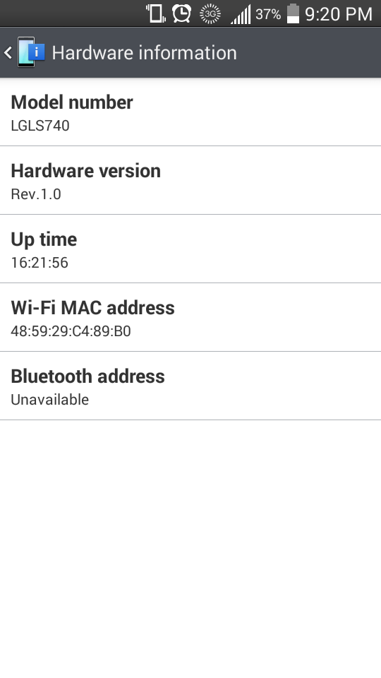

In response to the posts about differences in hardware, I found this listing about a hardware version. I'm running on stock zv3 on a Virgin Mobile phone.
I'm on zv5 with a Boost Mobile model. And I'm also at Rev.1.0.
Does your rear camera/GPS work in CM12?
I haven't tried CM12 yet, or any other rom for that matter. I've just been sitting on zv3 this whole time. But yea, I was hoping people could use this to identify why some are having issues and some aren't, if it really is a difference in hardware that's causing problems.
I have Hardware Rev 1.0 on ZV5. I'm on Virgin Mobile and have no rear camera or GPS on CM12.
I've got rev 1.0 too, on Boost, but my camera works in CM12. Maybe some of the more detailed device info from one of the kernel tuning apps would show a difference?
