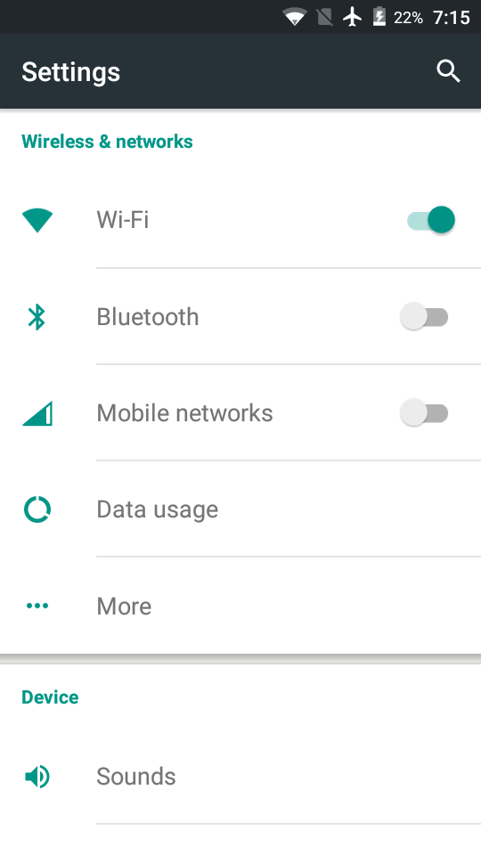

I've tryed several times to get the APN to stick but never shows up in my strings
I get no sim no matter whatView attachment 89068 why do I have a no sim icon in airplane mode
