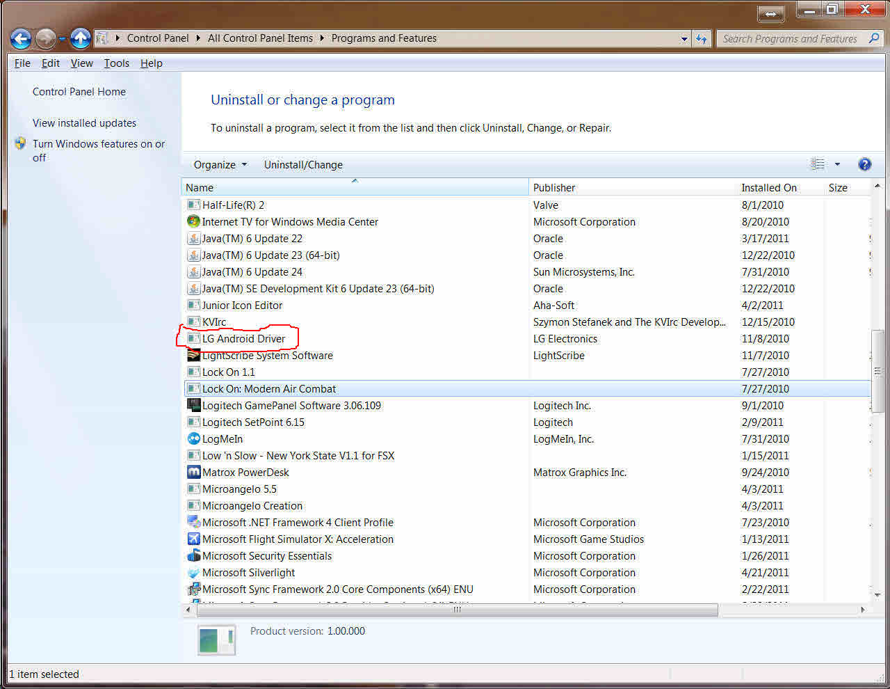

Glad you got it working, Azuma, but I'm not too sure on that error you are still getting. Since I just did these to screen shots to hopefully be helpful in your efforts, I'll attach them anyway. These were taken with my Ally connected by USB to my Win7x64bit Home Premium PC. One is what you should see in Device Mgr, and the other is what you should see in the programs and features list (Add/Remove programs, back in WinXP).
Maybe this will shed some light on the remaining error. Perhaps you have unwanted duplicates of a driver installed? You should not see any yellow question marks in Device Mgr.. See the items circled in red.
:mad:Just tried it today to see if it still works and that's a big NO!!! I compared the screenshots and I have the ones you have listed(thanks). So I suppose I'm gonna beat my head against the wall a little more!?!? I just don't get it? I feel like a total douche all of a sudden?
Is there like, a list of, or checklist of required drivers somewhere, cuz I'm kinda gettin' a little short-tempered??? Thanks..:mad:
