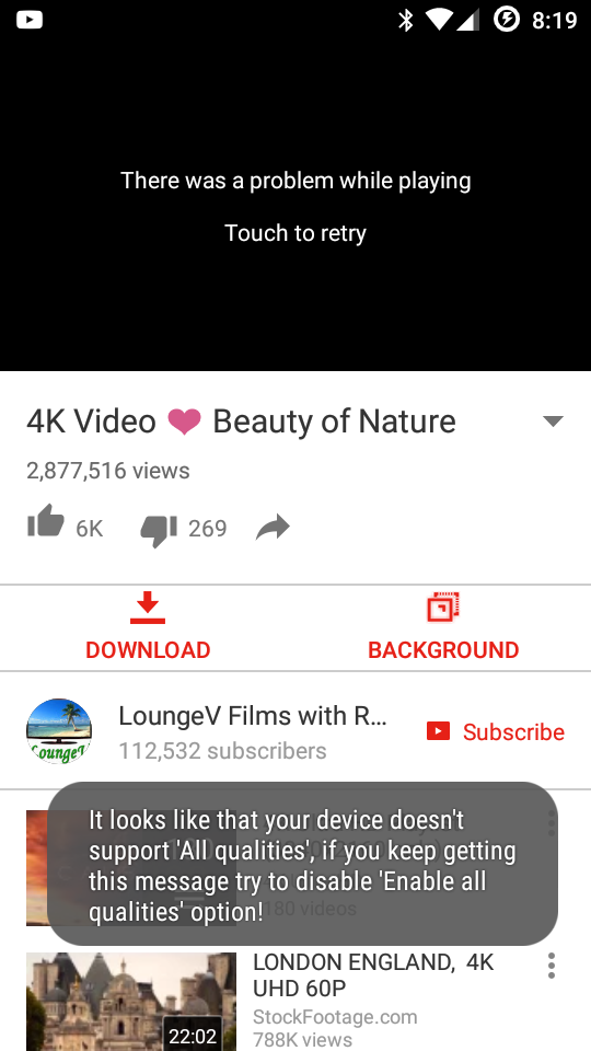

Lag? Are you sure it wasn't buffering? Everything I've tried so far works like a treat. Couple of games like GTA3 from the Play Store work fine. OGMods YouTube hasn't stuttered at all for me and I can view videos up to 1080p but it throws a error at 1440p which makes sense (attached screenshot). Apps that didn't play video at all now do like Crunchyroll (yes anime lol). NFC, OTG, and the backlight on the touch buttons are the only things I find not working so far in the ROM.
