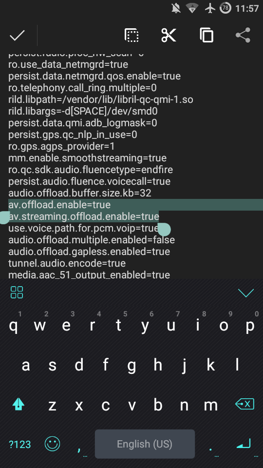

Its not buffering, I have decent WiFi (25 Mbps) at home so 720p videos never buffer but I may have found a solution, I'm not sure if it will work but if you change the following build.prop lines to "false" then it will fix the problem.
I'm on CM11 so I can't test, if anyone can than let me know
