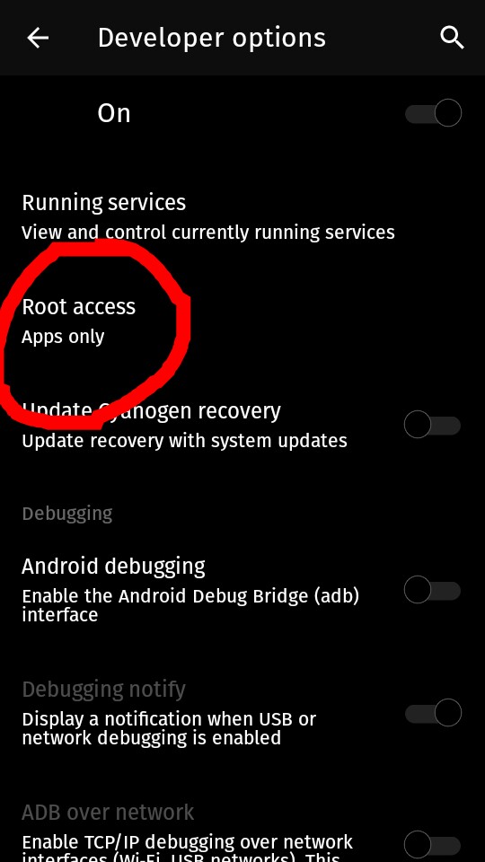

Ok so where are the root settings in the ROM, so I can allow an app or apps full root? Is it under PrivacyGuard ? On some apps a popup asks if I want to allow root and remember this setting I click yes remember it then next time it asks same thing so its not remembering. hmmmmmm
It's in the Developer Options menu which is enabled by tapping the FW build number 7 times (common to all Android flavors).
