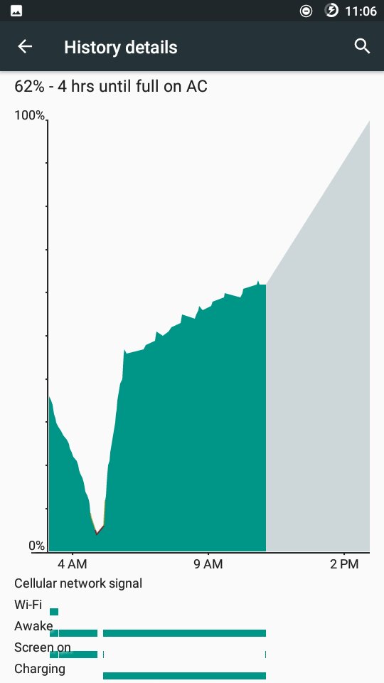

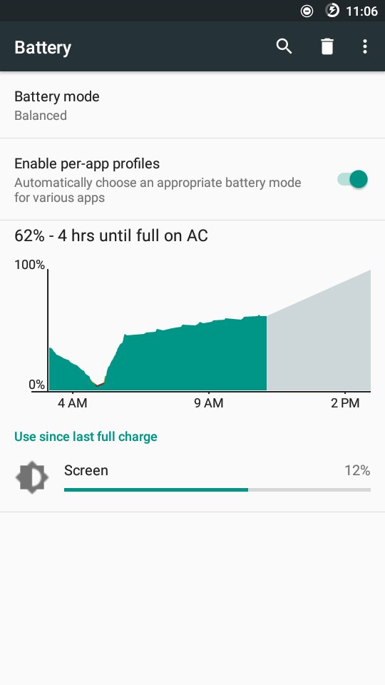

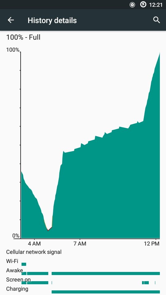

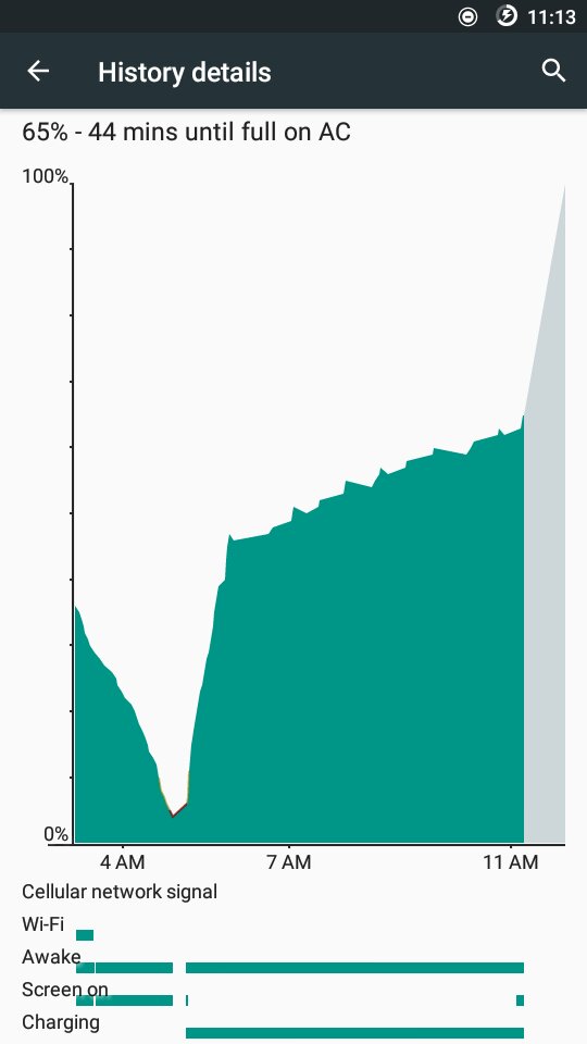

Any ideas what went wrong here? I plugged my phone in before going to sleep and when I woke up I saw that it was charging really slow so I unplugged it and plugged it back in and than it worked fine.
Edit
Happened again last night
