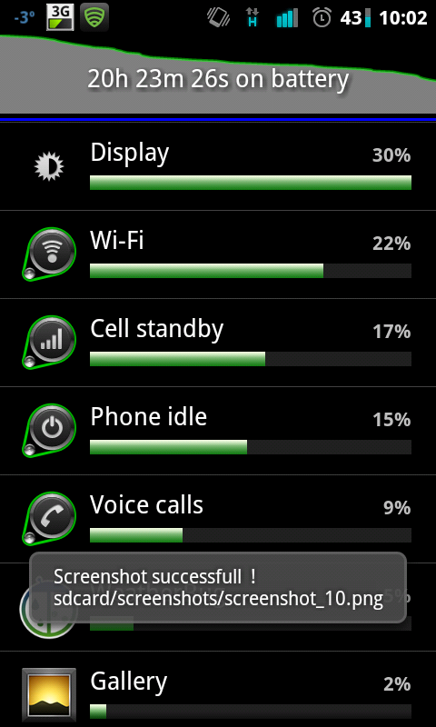

This is where I'm at:

At any rate, my stats are miserable...
6h 47 min on battery -- 74% left
Thats doing nothing on the phone since we were watching a football game and then a movie...
Voice calls 25% (thats one 6 minute call)
wifi 21%
cell standby 16%
display 16%
Phone Idle 15%
Weatherbug 4%
Android OS 2%
Gallery 2% (gallery 2%? I haven't opened the gallery today...)
Standby and Phone idle - these aren't the same things?

your time charge stats seem similar to mine I think.

Don't forget it all adds up to 100% so the lower screen is, the higher everything else must be
