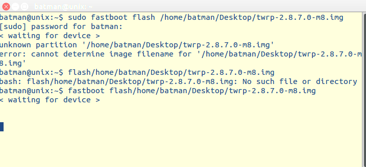

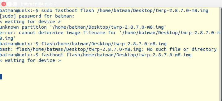

Hey @Arc_Eus, just a quick pop-in here...I just wanted to point-out what the issue is with your flashing command in post #26 above (I haven't looked at the XDA link you provided in post #27 above).
The correct syntax is actually:
sudo fastboot flash recovery <recovery-image-file>​
(the generic syntax for the fasboot flash command is fastboot flash <partition> <bootable-image-file> and in your case you're wanting/trying to flash the TWRP custom recovery to the recovery partition using the bootable recovery image /home/batman/Desktop/twrp-2.8.7.0-m8.img)
So, I'm guessing you'll want to do this:
sudo fastboot flash recovery /home/batman/Desktop/twrp-2.8.7.0-m8.img​
Don't want to hijack what the others might be having you do, but I wanted to point-out this common boo-boo :).
Cheers and best of luck!
