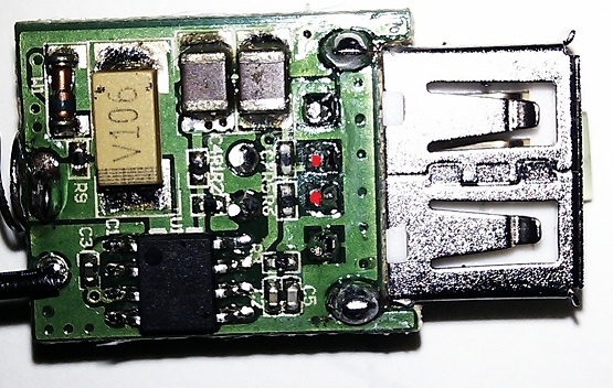

Ok, I have got to the bottom of the car charging issue, and it's the phone that is the culprit, well sort of.
Basically the desire detects whether it is on USB or AC charge.
If on USB charge it will draw no more than 500ma to charge, as I believe this is the max that a PC USB connection will supply.
If on AC it will draw around 900-950ms current.
How does it know it's on AC I hear you ask? Well I'm not sure about the HTC mains charger, but if you short the data pins (the two centre ones) on a car charger, the phone thinks it's on AC and draws the current accordingly.
I have tested this with a charger from Maplin
Micro DC to USB Adaptor : Caravan & Camping : Maplin
I opened it up and soldered the two centre pins together, see attached pic, the red dots indicate the two pins I have soldered together.
The charger will now happily charge my battery whilst I have Bluetooth and Navigation running, and whilst making/receiving calls. This was also using the HTC supplied USB cable, not sure if it is true, but I have read that the cable can also affect charging.
Obviously the car charger needs to be able to supply the correct current, so making this mod on a charger rated below 1A is not worth it.
I take no responsibility for any damage cause by this, as I say it worked for me using the above charger
